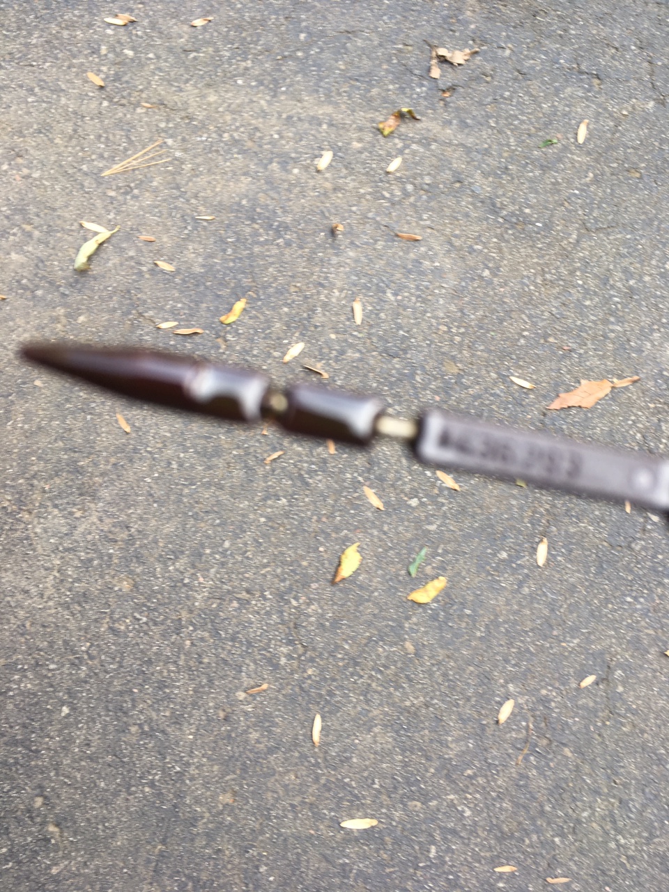

When i took it to get the oil pan gasket fixed i noticed in the invoice they put 8 quarts in. Today I looked at the oil level and the entire center block is wet and oil touches a bit of the next section covering the 1st number in whatever that code represents. Is it too much oil and if so, how do i drain a little bit without ramps? Attachment 34106
Ok cool. Thx. Wish the dipstick had the max line the way others do
