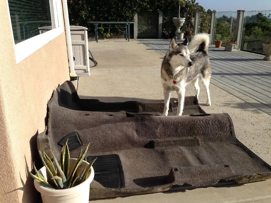

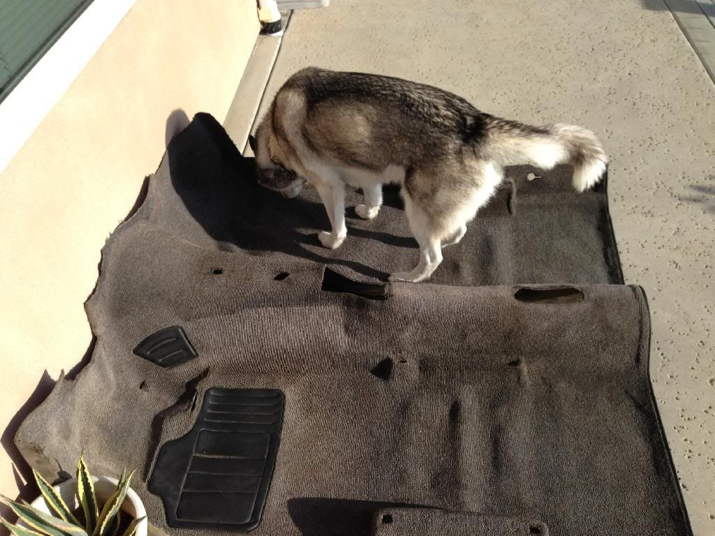

There's still a lot of dirt in it, I need a few more passes with the Bissell before I'm happy re-installing
