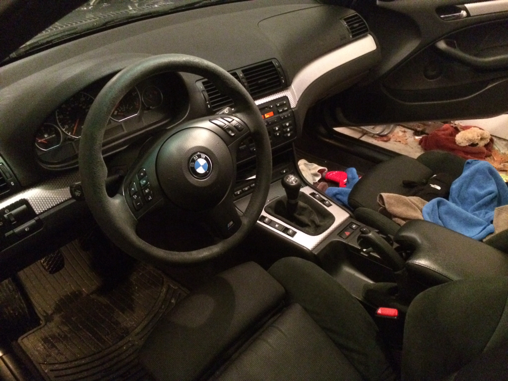

Yesterday I washed and waxed her and cleaned her interior. I used the magic eraser on the steering wheel and rear armrest and it worked really good. I just need a lint shaver for the excess pill up on the wheel. I attached a pic of the cleaning in process. I go through a lot of microfiber towels.... Attachment 11725
