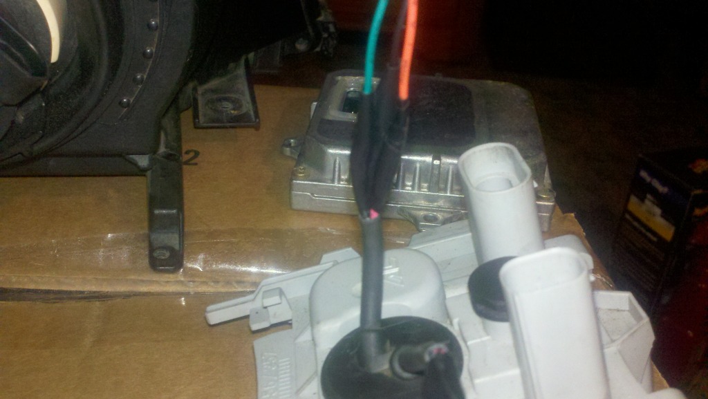

Finally secured my Driver Side Ballast in style.
Engine Bay Cover, xenon headlight control unit 63127832829 QTY 1
Engine Bay Bracket,control unit, Xenon light left 61127893034 QTY 1
Engine Bay Fillister head screw 72128244154 QTY 2
Engine Bay SELF-LOCKING HEX NUT 64509123157 QTY 1
Had to do some surgery. Cut and splice an extra 12 inches of copper wire for each of the three wires in the two black sheaths. Wrap in electrical tape to clean it up there you go...M3 Ballast relocation for non-M e46s.

Ballast was interfering with the Long Tube Intake.
From my dealer, total cost was $23.XX. Plus the 90' pack of 22 gauge copper wire was $7.41. Easy mod/improvement.
