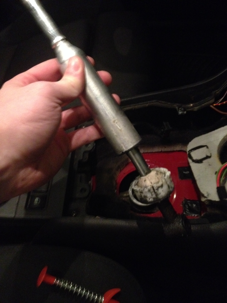

Impressions:
Slop down 85% (total guess). It's a lot tighter to the point where the slop is acceptable - it's no gated shifter - even some new cars have more play in their shifters.
Shifts are notchier and more direct.
Downward throws (1-2, 3-4 etc) are noticeably shorter, but the upward throws aren't too much different.
Totally worth it. I'm very happy with it so far.
