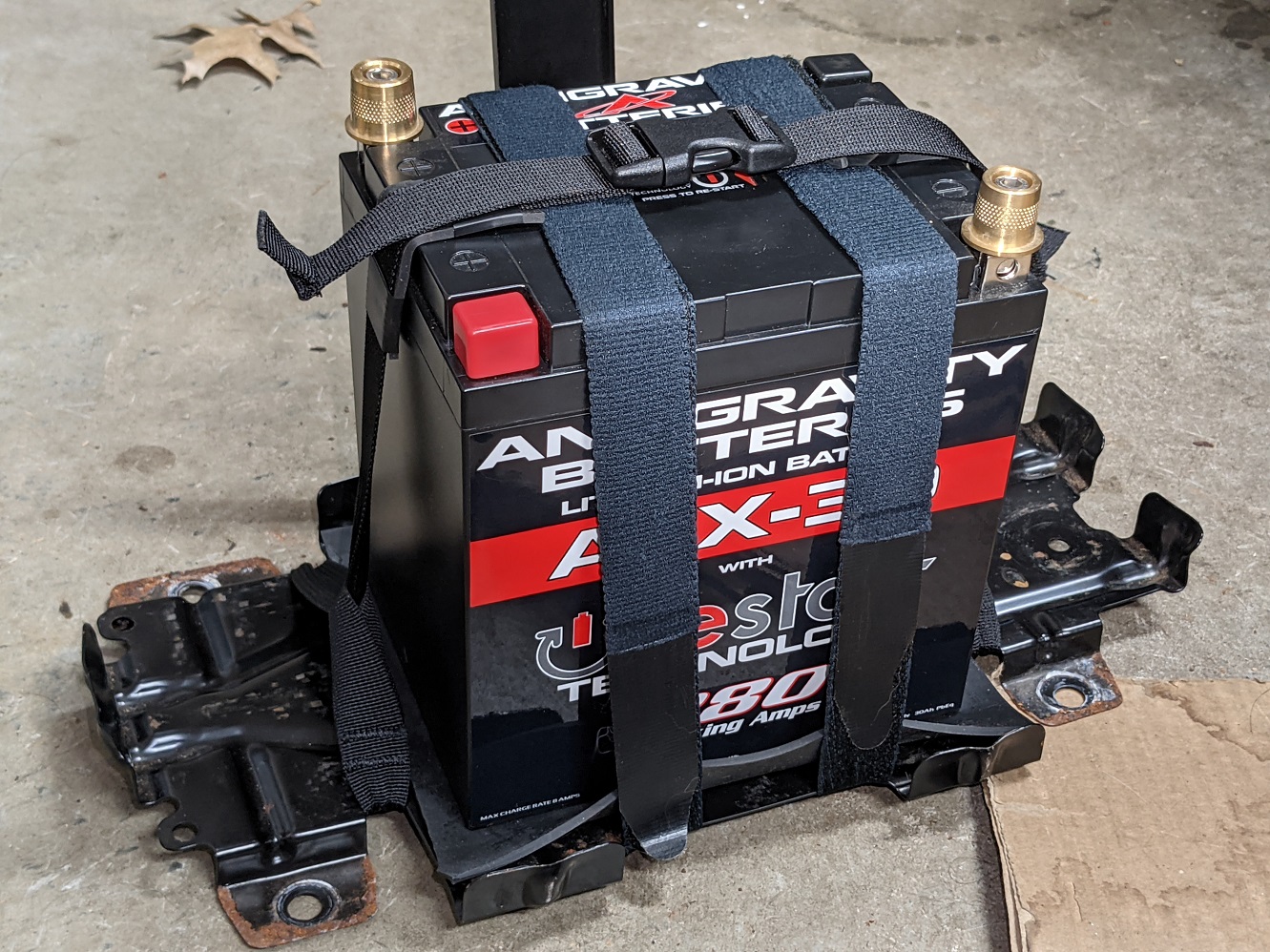

On behalf of the Pizzaman himself, who could not be here with us today, here are some details on the LiFePo4 battery he installed (and that he convinced me to buy as well).
To secure it, he created a special custom high-tech mounting solution.
Attachment 38810

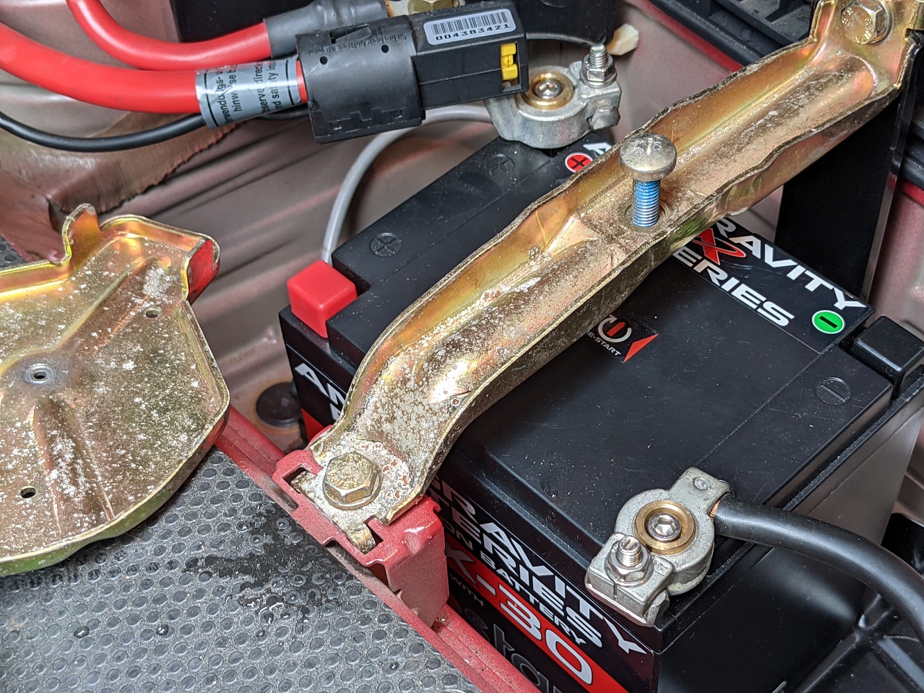

You can try to use the original mounting system, but it does block the restart button which is apparently quite useful.
Attachment 38811
He also got this charger, since you need one suitable for LiFePo4.
https://www.amazon.com/CTEK-56-926-L...964491&sr=8-13
And these if you want to keep your stock terminals.
https://www.amazon.com/gp/product/B0...P2NQRBZG&psc=1
Thanks man! Just found this pic too -- 50lb savings over the chonkin stock size battery!
https://uploads.tapatalk-cdn.com/202...b3dfb03c4f.jpg
It definitely threw off my corner-to-corner balances, but less weight is almost always better.
Does a damn fine job of starting the car too. I've had to use the restart button a few times after it died on me, but that from was leaving the car sitting for 4+ weeks, usually when I left an OBD2 dongle in the port [emoji2357]
Edit: Just saw that I already posted about the battery last year [emoji2357][emoji2357]
