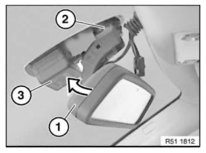

John,
I just went by BMW's instructions:
This was at the top of the document:
Caution!
Do not under any circumstances turn the interior rearview mirror when removing it.
Twisting off the interior rearview mirror from the mirror mount will damage the rear catch.
The mirror will wobble while installed if the rear catch is damaged.
Do not snap out the interior rearview mirror (1) towards the rear (windshield breakage).
And this was in the detailed removal instructions:
Caution!
Do not remove interior mirror (1) towards rear or by twisting (risk of damage).
When snapping out, do not damage control unit (3) for rain sensor.
Snap out interior mirror (1) from mirror mount (2) towards front by striking with ball of thumb and remove.
Attachment 31835
It didn't take a lot of force to pop the mirror off using BMW's method, but I could see if the glass was chipped or weakened in some way, it could be a risk.

Man that procedure is bizarre. I've twisted the mirror on and off at least a dozen times and never even considered it to not be the correct method. Love that BMW's professional instruction is to punch the little bastard right off.
