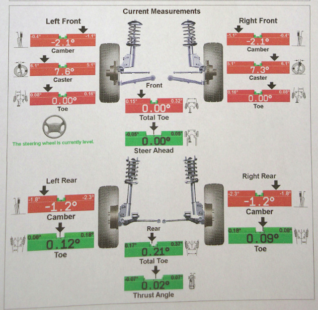

Yeah they increase caster and camber, here's a quick shot of my alignment with those.
Attachment 37489
I'm not at all sensitive to tramlining so I can't comment on that with these mounts. I wouldn't even know how to detect it.
