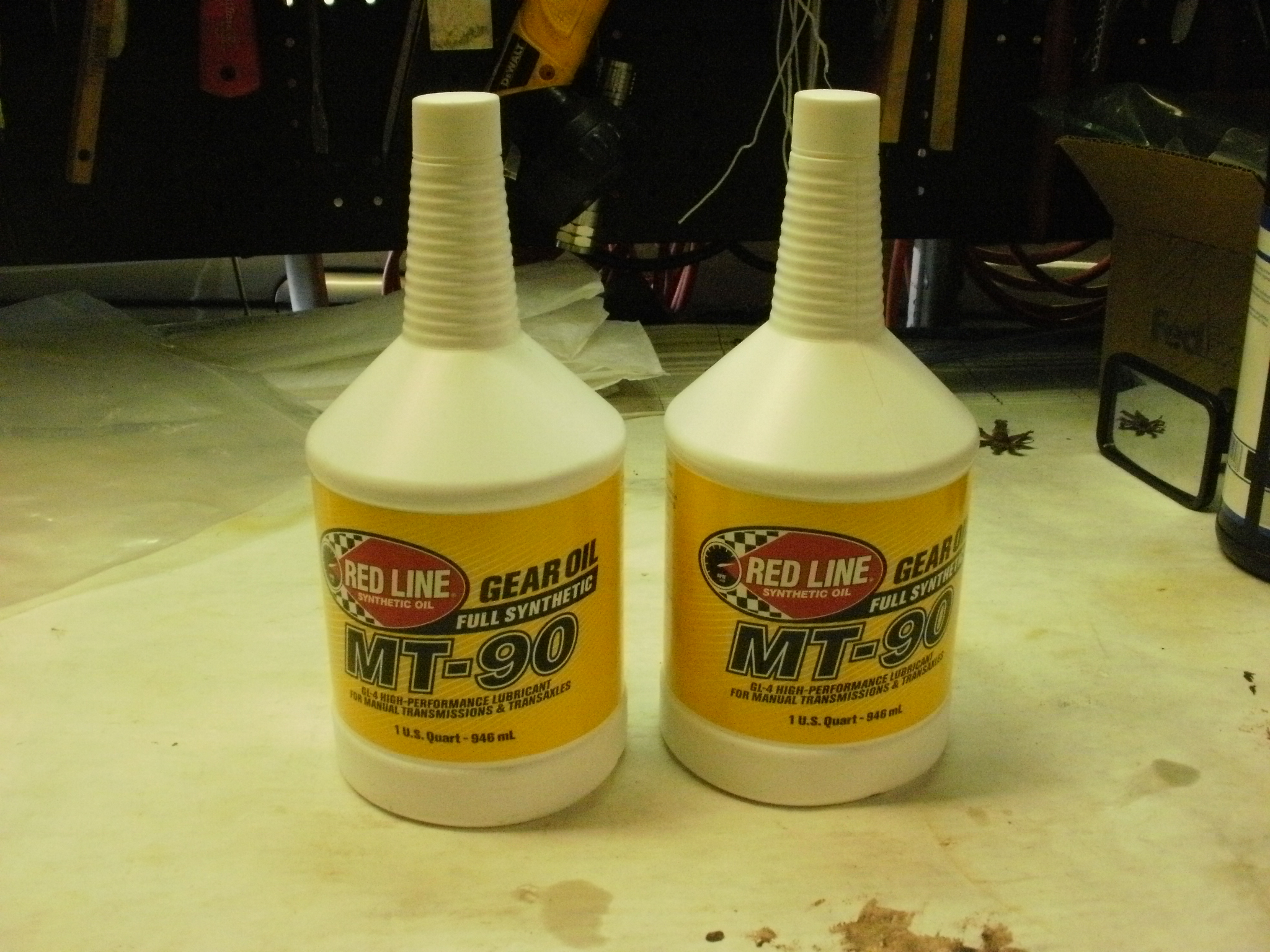

What fluids would you guys choose for Differential Fluid change? Lubro-Moly or Redline MT-90? Thanks.
Attachment 24916Attachment 24917
Redline for diff/tranny
Sent from an S6 Edge
I used what San used, Redline 75W90.
Redline
Redline for tranny and diff.

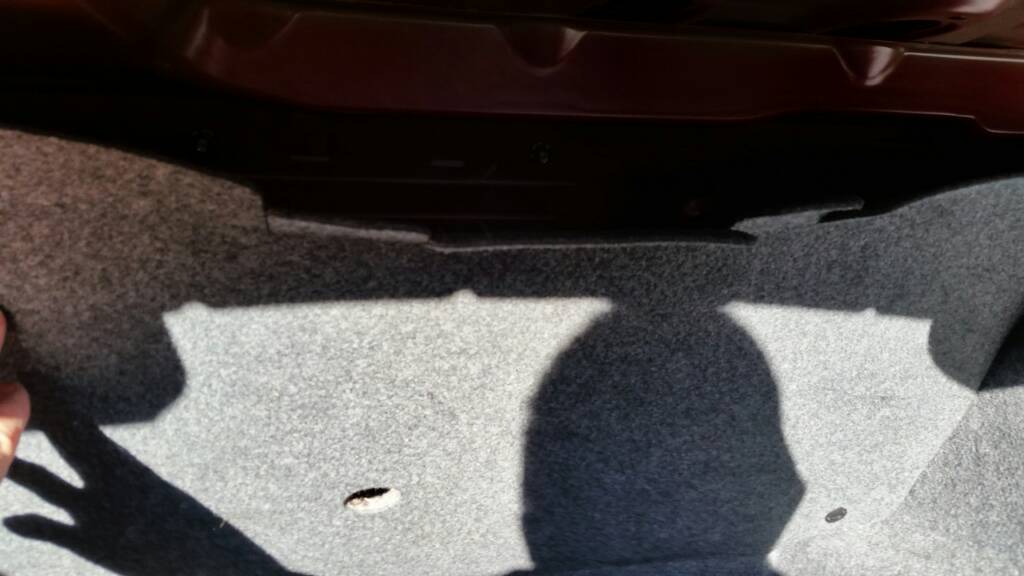

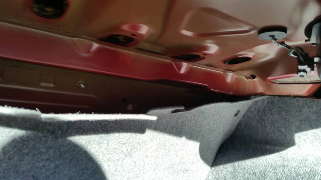

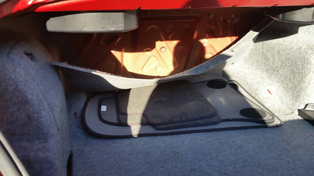

I have a non folded back seats and the cover in the trunk is sagging. I am not sure how it should be attached. There is a hole in the middle of it, but I don't see any spot where a clip can be attached. There are few spots where clips can be attached. I placed them, but the top section is still sagging.
It looks super annoying any time I am opening my trunk. I have a feeling that I am missing top cover, if such thing exists.
My be somebody can take a few pictures of the trunk lining layout for me. Here is my mess
Attachment 24972Attachment 24973Attachment 24974
It's sedan
