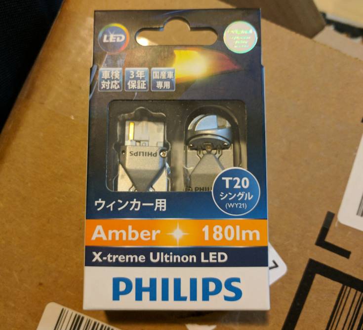

that looks like a resistor pack to me. use the bulbs and turn off all the checks. then you don't have to install that huge thing
Turning off the checks isn't going to solve the hyperflash you get if you don't install it.
Unless the bulbs specify they are CANBUS bulbs, you'll need to use the resistor pack. In this case, the box states a CANBUS adapter is included; that means it's a resistor pack.
Looking at the package--I don't see anything about CANBUS compatibility. To confirm, these 1st gen Philips bulbs dont have the resistors and are simply plug and play...?
Attachment 37367
I haven't seen any CANBUS bulbs from any of the "name brand" manufacturers (Philips, Sylvania, etc.); they all require resistors. If it doesn't come in the package, then it will need a separate resistor. The Sylvania bulbs I purchased for the touring, for example, required resistors that had to be purchased separately.
Based on my searches, the no-name brand aftermarket is where the CANBUS bulbs seem to be. Those are bulbs that have the resistors built-in, which eliminate hyper-flash.
Yes, the Japanese ones were plug and play with no errors or hyperflash. We only disabled the hot/cold checks because it makes them flicker like a damn strobe at startup (cold check) and randomly (hot checks).
@az3579 it's a facelift coupe thing...you wouldn't understand lol
Yeah, I have the same ones as ZHPizza and the box included just the bulbs. No resistors. No issues.
I wrote PowerBulbs where I bought the bulbs. This was the response:
Hello,
Thank you for your email.
I can confirm that the bulbs purchased are second generation. More recent Philips products have included a canbus adaptor along with the bulbs which just saves individuals making another purchase if they run into canbus issues.
The bulbs can be installed on their own, with the adaptor being used as a sort of backup option if you run into problems. We find that some vehicles do need the adaptor while others do not, but if you see warning signs on your dashboard pop up after installing the bulbs on their own then the adaptor will have to be used.
If we can help answer any further questions you may have please get back in touch.
Kind regards,
PowerBulbs
