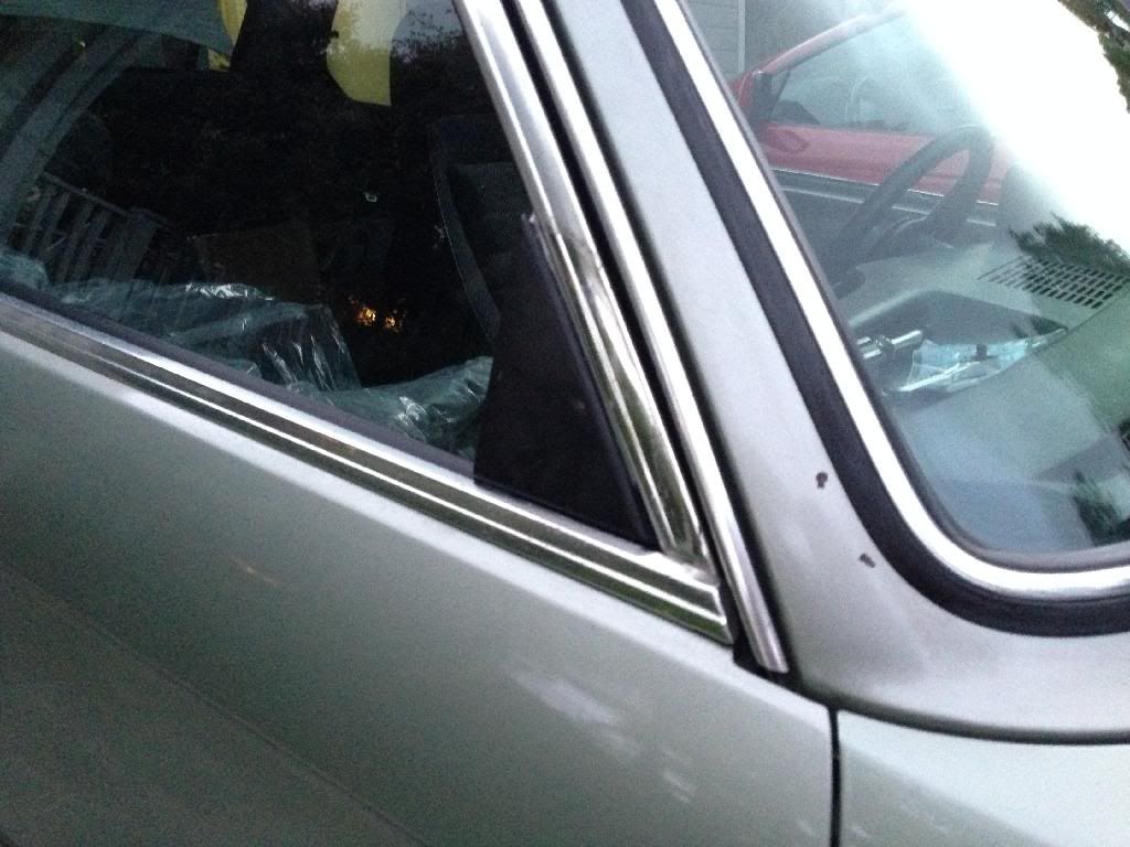

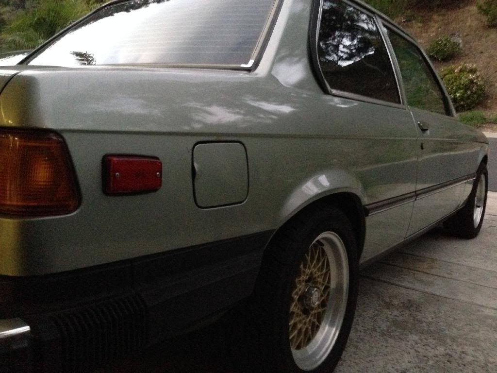

Passenger mirror delete

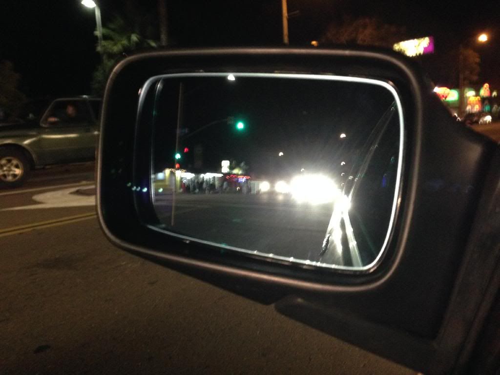

Euro wide angle lens for drivers side
