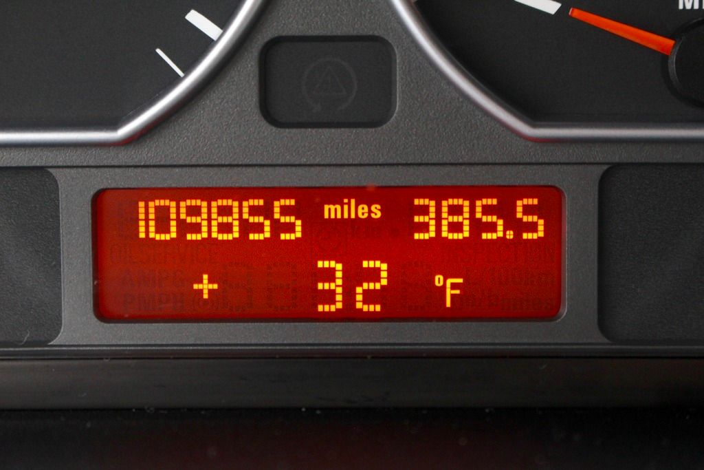

Current Milage 110,400

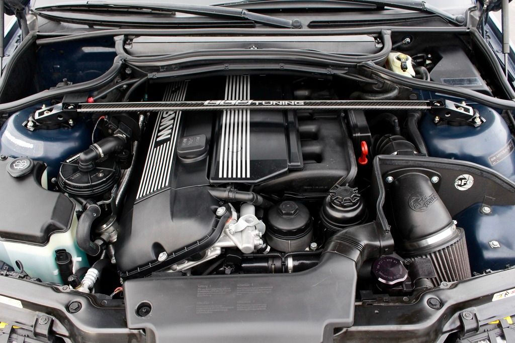

Engine/Performance:
Oil Changes every 7,000 or so with Bmw Twin Power Turbo 5w30 and Mann oil filter
Afe Magnum Force stage 2 cold air intake (100k)
Oem Valve Cover Gasket Kit (104k)
Beisan Vanos Seals repair kit (104k)
Beisan Vanos Rattle repair kit (104k)
G.A.S. Disa Repair Kit (104k)
Cleaned ICV (104k)
Inspected Intake boots (104k)
Cooling System Overhaul (105k)
GEBA water pump
Fan switch
Thermostat
OEM Expansion Tank
Level Sensor
Upper and lower radiator hoses
Belts
ECS Aluminum PS pulley
ECS Aluminum water pump pulley
Starter replaced (105k)
Hydrolic tensioner pulley (105k)
Idler pulley (105k)
A/c Tensioner (105k)
NGK Laser Platinum spark plugs (106k)
Fuel Filter replaced with Mann filter (107k)

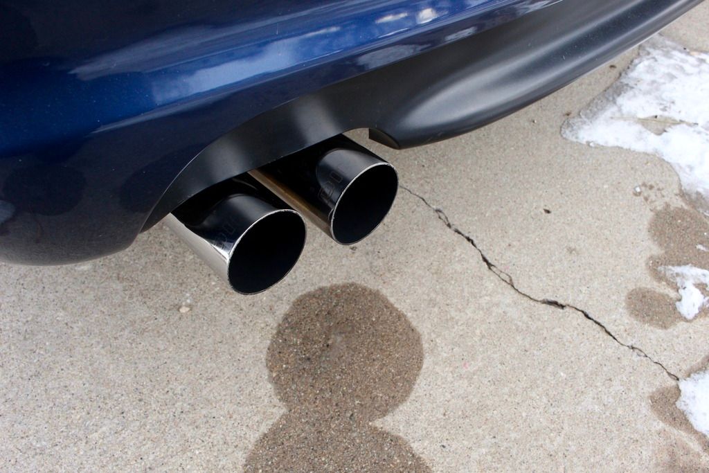

Dinan axle back exhaust (109k)

Ecs carbon strut bar installed

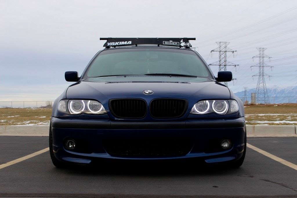

Exterior/Lighting:
Ecs Blackout grill
Yakima Roofrack
Oem Euro clear lens package
Depo foglights
Stealth Bulbs all around
Umnitza predator Orion v2.5 angel eyes
Ziza LED License plate lights
