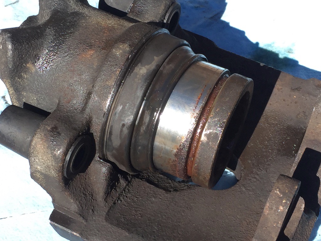

My left (driver side) front caliper was sticking. The rotor looked OK, so I ordered some remanufactured calipers from BavAuto. They carry the Nugeon calipers. BavAuto says they don't come with brackets, because Nugeon often ships the wrong bracket with the caliper, but I hit the jackpot, and both calipers had the correct bracket. I guess they do a hot wash or sandblast these things, because they look brand new, and they are the original equipment BMW Ate calipers and brackets. Nugeon replaces the rubber guide bolt boots and caps, the guide bolts, the piston and piston boot, the anti-rattle clip, and the bleed nipple. Nugeon's rubber boots were very soft, and the cap didn't want to stay on, so I swapped them with my original Ate boots and caps. Much better, and the rubber looked perfectly fine after all these years. I also swapped the bleed nipple. The one they include uses a smaller nut, and it looked inferior, so I swapped over the OE nipples. I did use their included anti-rattle clips.
Here is why my caliper was sticking. The boot had failed allowing moisture to rust the piston:

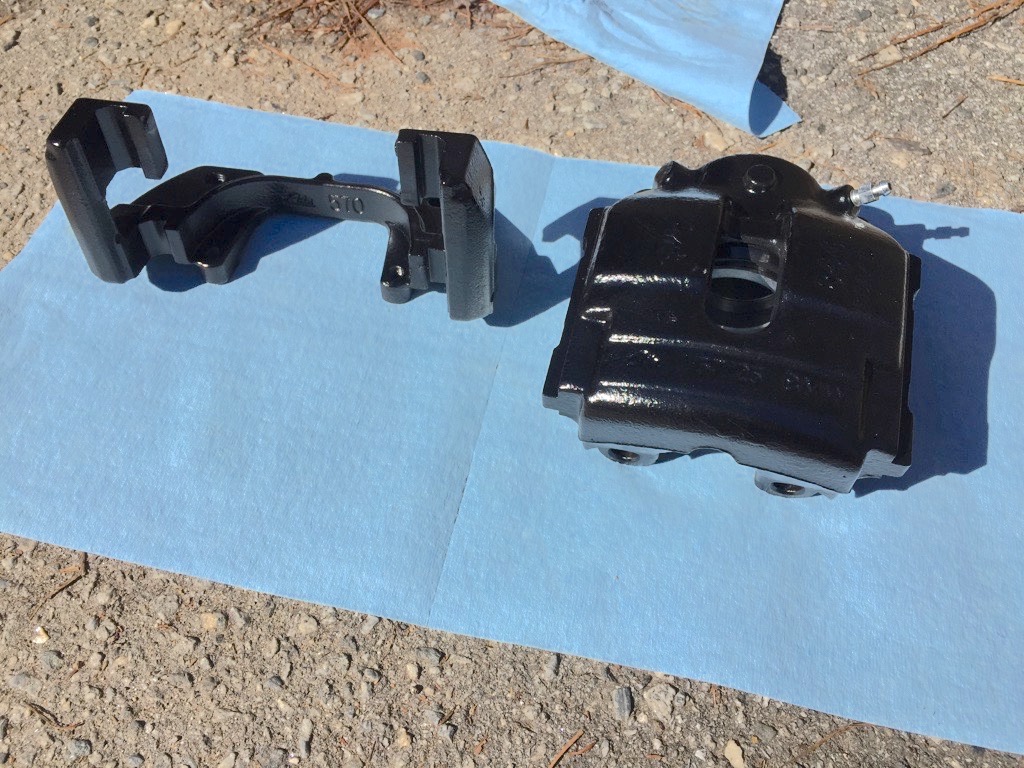

It's so nice having clean brake parts, so I took advantage and degreased them, then painted them black before putting them on the car.

Car sat in the rain for two days waiting on calipers, but that rust was gone after the first test drive. The paint is gloss black, and it's reflecting the blue shop towels in these photos.

Nice that they come pre-painted.
Sockethead, they don't come pre-painted. The do, however, come very clean. They are bare metal but with a thin coating of oil to prevent rust. I wish I had taken a picture of them before I painted them to show how nice they are. It just made the job very easy to degrease them and paint them with caliper paint before I put them on the car.
Salty
Alrighty then, nice paint job... Looks like they came that way ;)
