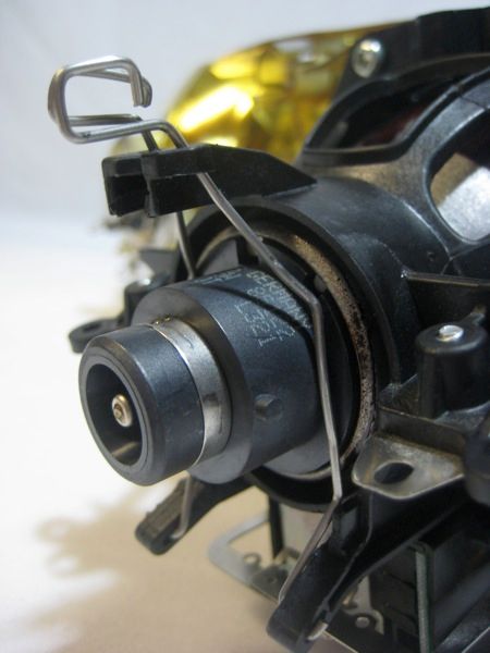

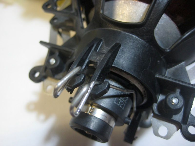

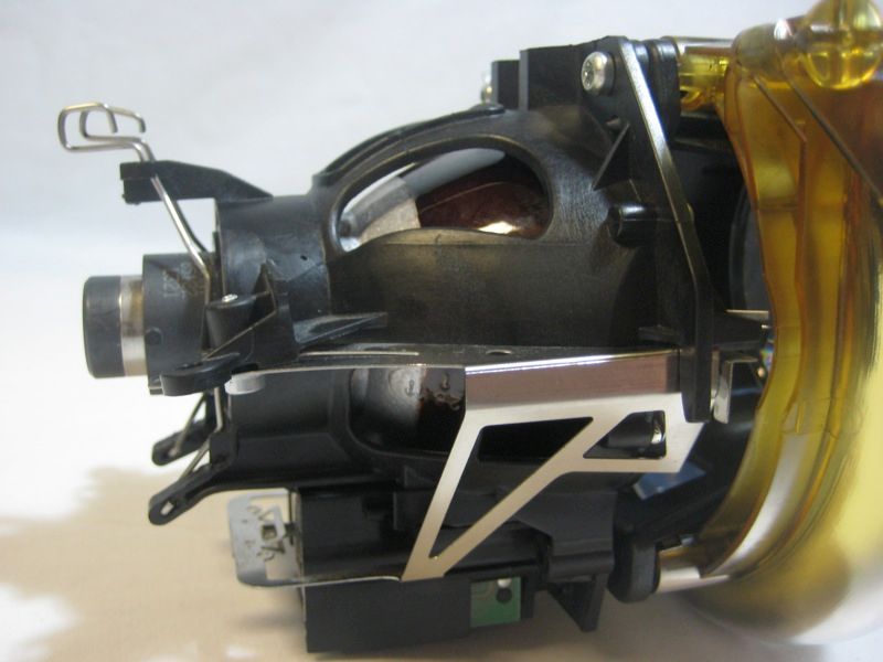

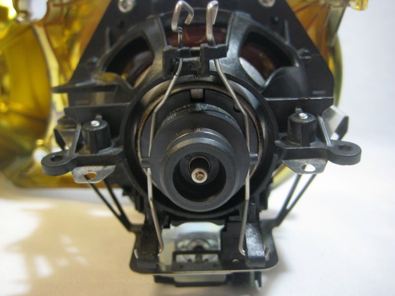

Hey all,
I read threw a little over half of this thread and saw JupiterBMW's build thread and saw that there where questions of how to retain the bulb for the E90 projectors. I though I would post a method up here as another route go. Here are some pictures of the end result.
http://i831.photobucket.com/albums/z...h_b6566fb0.jpg http://i831.photobucket.com/albums/z...h_5ac8cb78.jpg http://i831.photobucket.com/albums/z...h_c7a36735.jpg http://i831.photobucket.com/albums/z...h_936705b3.jpg http://i831.photobucket.com/albums/z...h_65bc8ccf.jpg http://i831.photobucket.com/albums/z...h_d79213fa.jpg
So there is another method to try out. I used the E90 D1S bulb retaining wire for this. I took off the small plate and cut the wire in half. I did a little dremel work to the housing to open up the second hook to accept the left wire. Then through trial and error bent up the wire so that the tension was appropriate to hold the bulb securely while keeping enough wire against the bulb to keep it flush.
