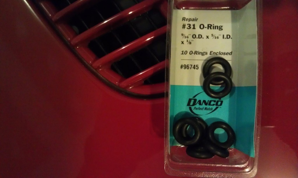

Does anyone know the dimension of the Lower Temp sensor O-ring? Its leaking from there.. And where i can get it without buying a whole new sensor?
Meric,
Here is a pic from Dane. I used the same o-ring from home depot and it had worked perfectly. I had to take the fan out behind the radiator to get to the temp sensor but after that it was pretty easy.
The temp sensor is pretty hard to pull out but just takes some effort. also remember you will loose fluid out the hole you create so be ready to catch it or expect it to get everywhere.
Attachment 5807
