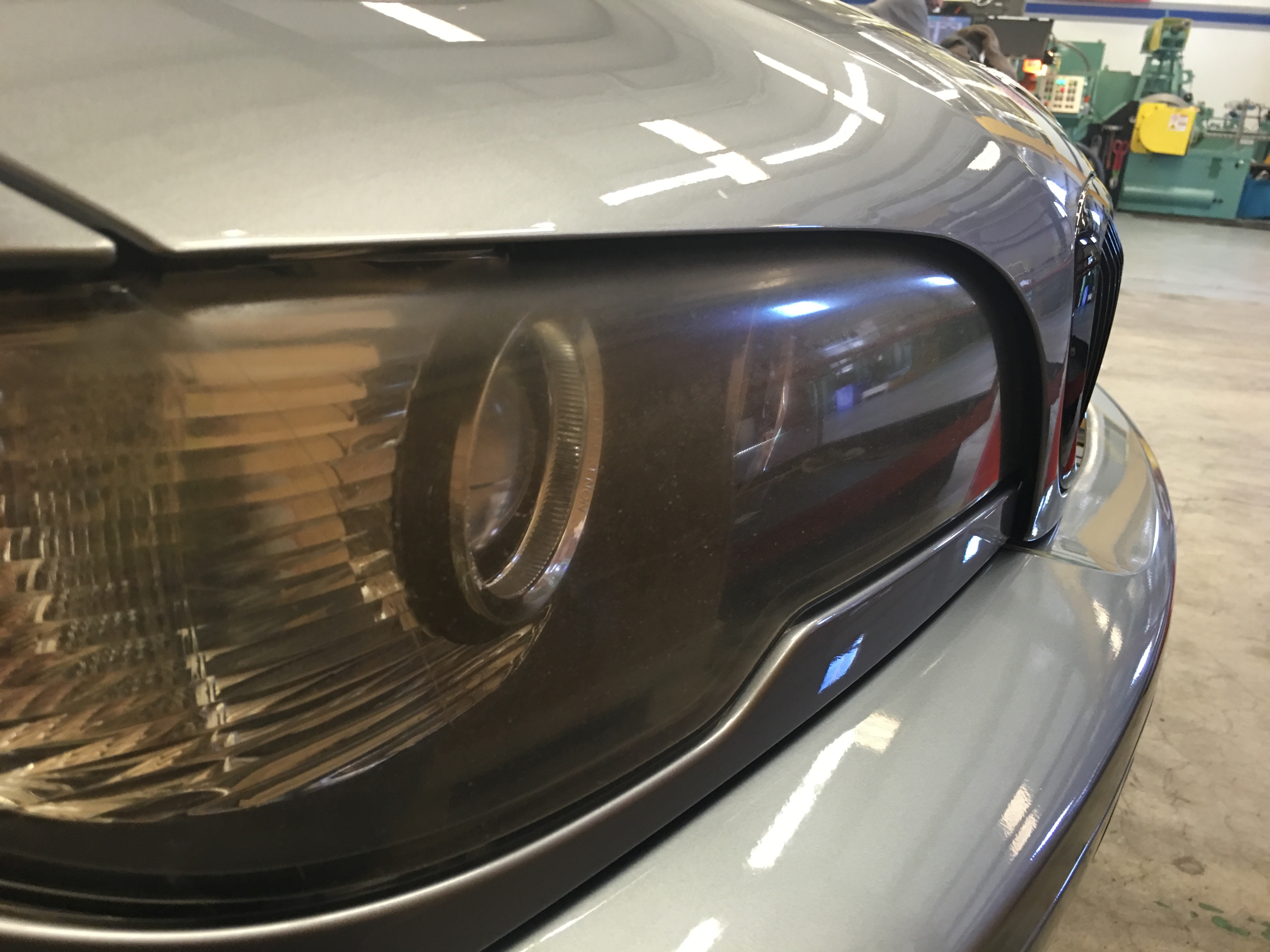

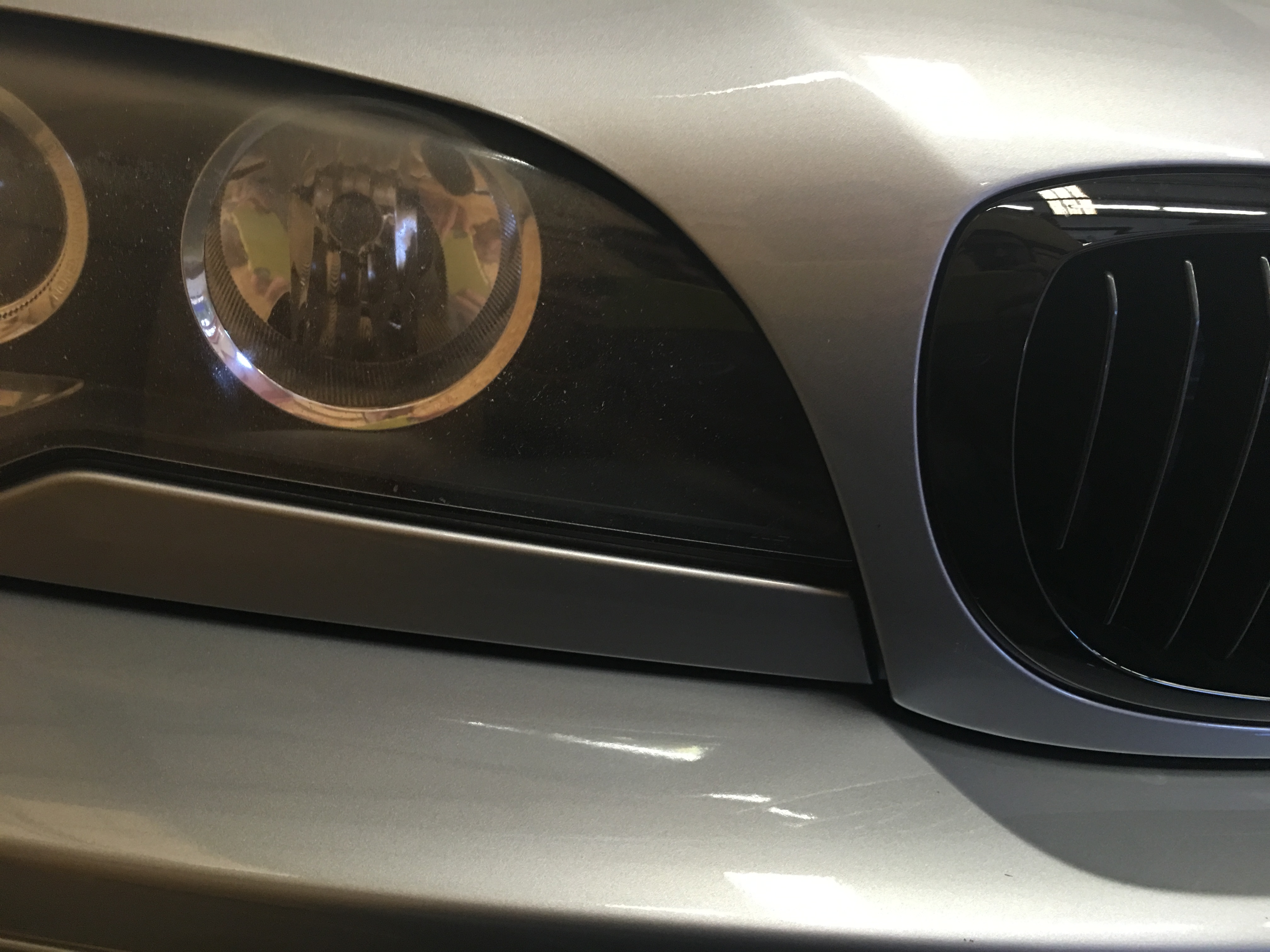

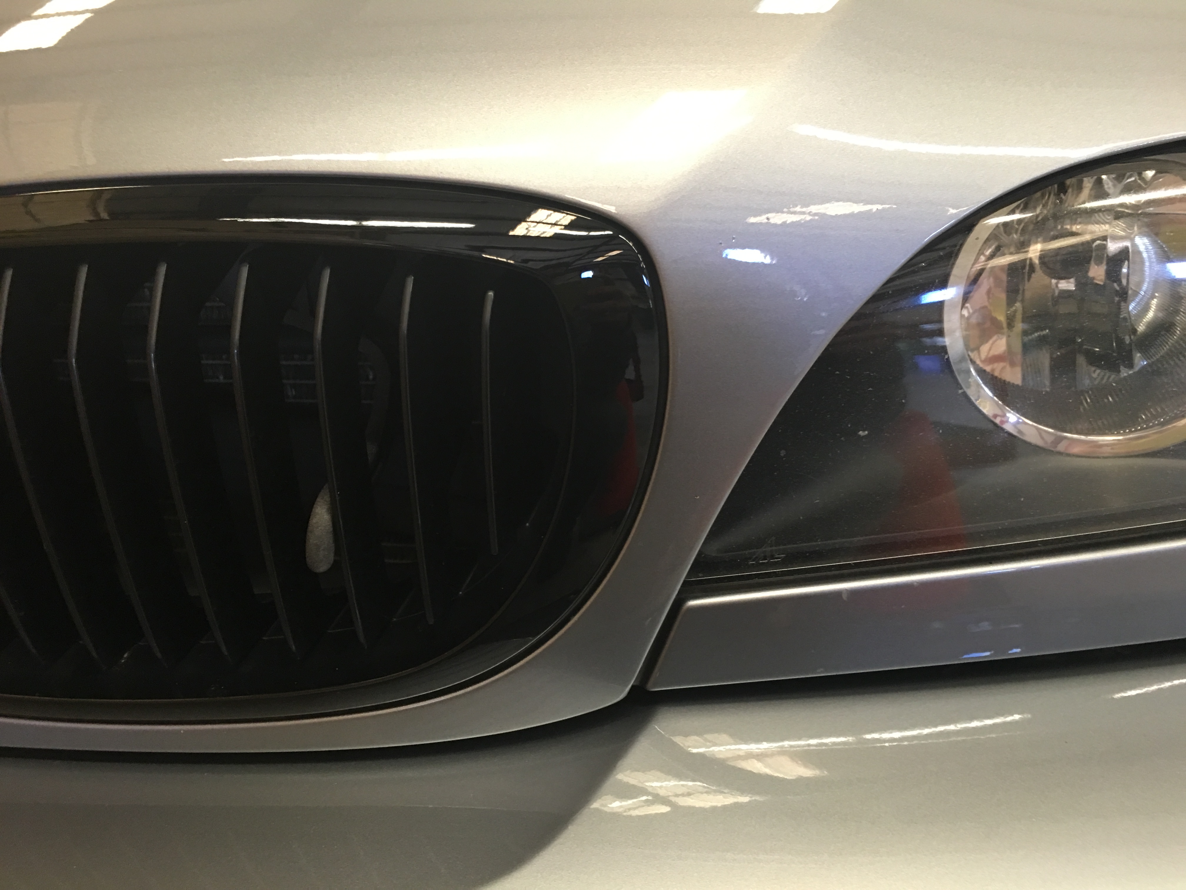

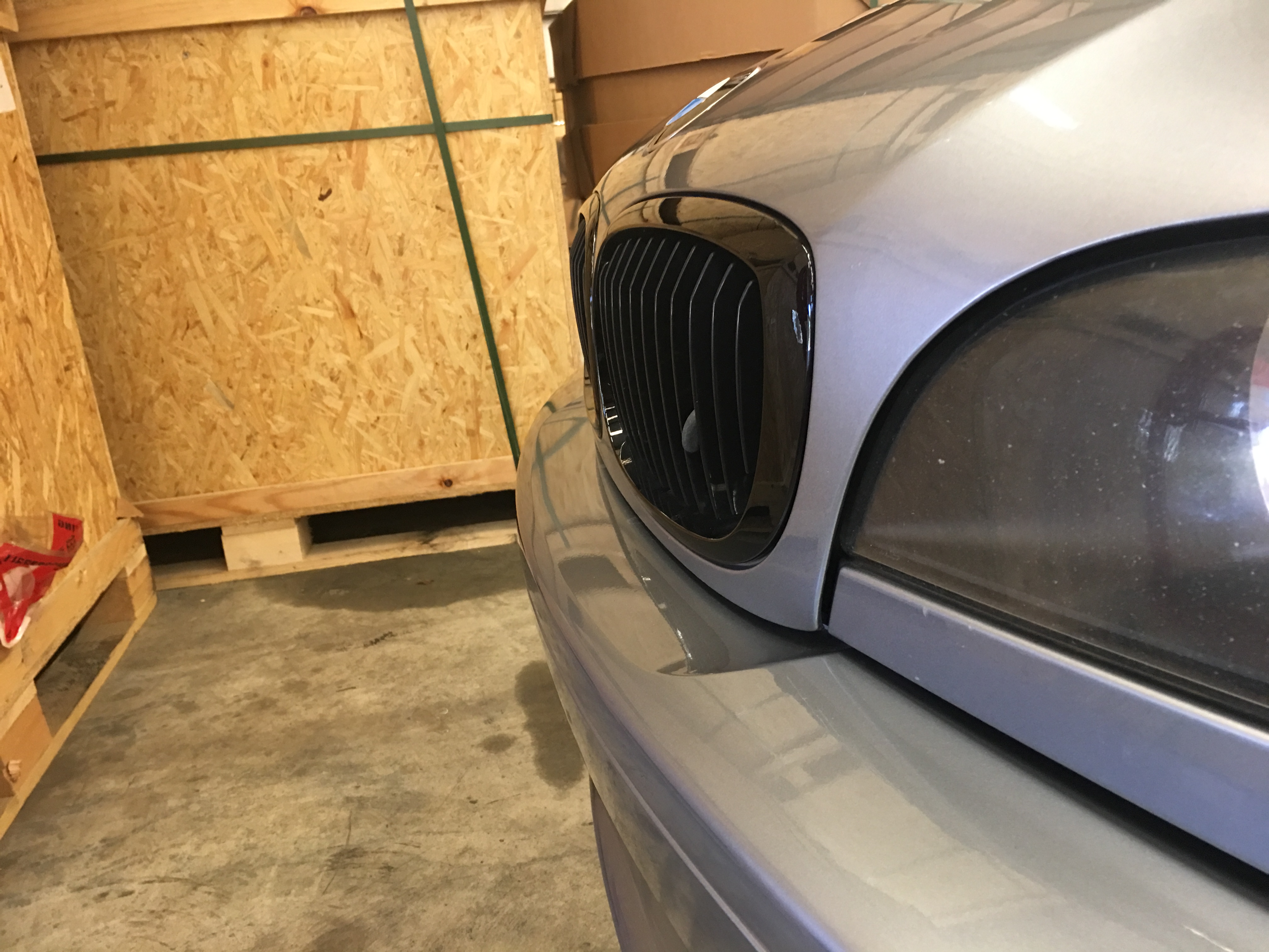

Ah so you're saying the grills could be sitting incorrectly causing it to askew to one side? Thanks so much for your help. I know it's rather silly, and a small imperfection, but I love this car... I so badly want it to be perfectly aligned, hah.
Wait I'm confused now, I thought the hood was misaligned and not the grills?
If I understood your issue correctly, you are saying the "gap" between the headlight and the hood (grill side) is not the same on both sides and that is what I noticed as well in the pictures... if this is your issue and since you mentioned the car was in an accident as well it is not possible (for me at least) to say what could be causing it without at least looking at it in person...

Yes that is exactly what I'm trying to figure out. More detailed photos wouldn't help? Would love to see if someone knows what the issue is. The accident was in wasn't even enough to deploy the airbag so I'm really hoping it's not damage like that. The previous owner was a BMW tech, so he put the hood on himself. I was hoping he just got lazy as he was trying to align it and said "f It" when he got it to latch into position successfully. The misalignment just bugs me. Please let me know if there's any pictures I can post that could help you help me. :) thank you for response!
Is the hood aligned correctly down the sides i.e. are the gaps between the hood and the fenders equal?
Yes. If it is not, it's minuscule I can't see it, in response to if the alignment with the fenders.

Just kidding, welcome to the Forum. There are a few different ways to adjust how the hood sits. There are also a few spots, that even in a low speed collision, could have been damaged and would prevent the hood from sitting just right. I will go snap some photos for you and can give you further details if you PM me. I was just in an accident with my ZHP and I am just about done rebuilding it.
On the core support, known as the front panel, there should be these black rubber nubs sticking up. You can twist them to raise of lower them. This would be the first check. Let me know if that isn't it and I will take some photos of areas for you to inspect for damaged. Check my build thread too if you want some photos of the front end.

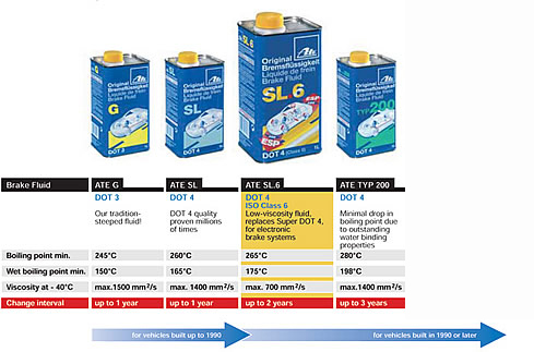

Some people say it may lack anti-corrosion additives but if it is changed frequently it will be fine. But according to ATE and the image below, under normal driving it can last up to 3 years.

Per BMW in regards to LV Fluid like the Ate Sl.6
"The Ate SL6 fluid is a low viscosity formula for modern ABS and DSC systems. BMW recommends low viscosity brake fluid for all chassis beginning with the E60 5-series. Low viscosity (LV) is a thinner fluid that works better than a normal fluid in the small channels and passageways in the ABS/DSC pump. Using the heavier fluid will result in a delayed response to ABS and DSC activation and a spongy feel in the brake pedal (only during ABS stops). Ate SL.6 falls just short of DOT5 specs so is classified as a DOT4. It can be mixed with other DOT4 or DOT5.1 fluid. For track use, a heavier high performance brake fluid such as Ate Typ 200 or Motul RBF600 or RBF660 is recommended because of their higher boiling point and because the thicker fluid will thin out at track temps. But for street use we recommend switching back to a LV fluid, especially in colder climates."
