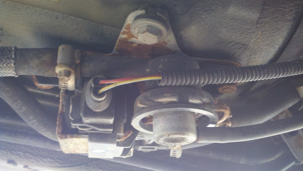

I got under the car today and fucked around looking at things. This is what my fuel filter and regulator look like:
Attachment 6242
Attachment 6241
The regulator has three hoses attached to it. One is the return line, it comes from the back of the regulator and moves to the left of the image. Then there is a single fuel line that comes off of the filter and moves into the regulator and then up to the fuel rail. the return line from the rail passes back through the regulator and then into the gas tank. And you can see the electrical connection...I'm not sure how that will affect things, but I unplugged it and started the car, gave it some gas and let it get warm, no issues arose. So I'm hoping it'll be fine to just delete that wiring.
Tomorrow is the big install day. I'll be installing the M54 Fuel Rail and the 330's 24#/hr injectors with the proper filter and regulator. Hoping to gain 5-10 MPG because city driving is netting me around 14...

Fuel filter, fuel rail and 24#/hr injector swap: mission success!
