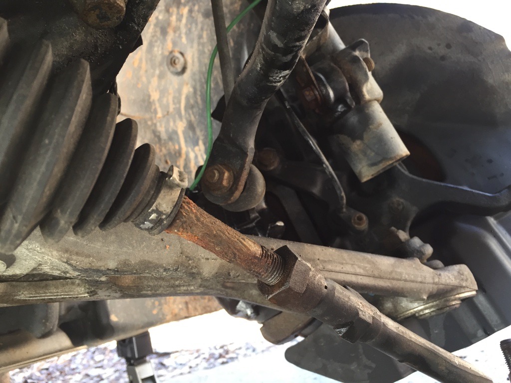

It looks like we're in for monsoon season here in NC. Have you seen the forecast, ZHPizza??? We have no sun literally until Feb 24. Whaaa? So, I had to git while the gittin' was good, and get my other tie rod installed this afternoon.

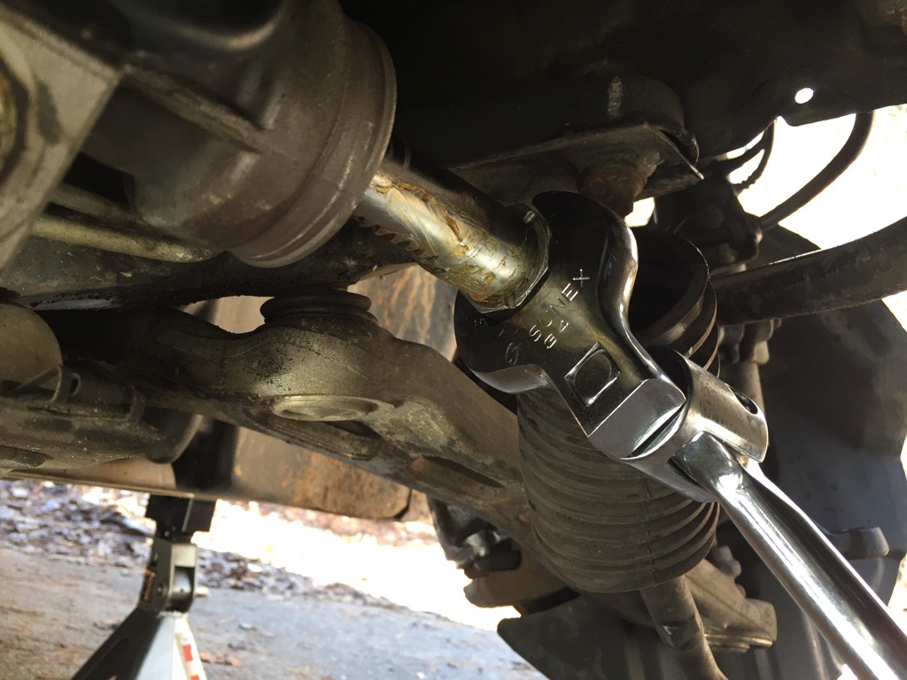

Man, that tie rod looks worse than my granny's wrinkled pantyhose. :) Maybe the work of a pipe wrench? I had to make liberal use of PB Blaster for these last couple of projects, so you'll probably see areas of wetness here and there. After these projects, I need to wash it and get it out of the weather. It's a muddy, nasty mess right now.
Attachment 31969

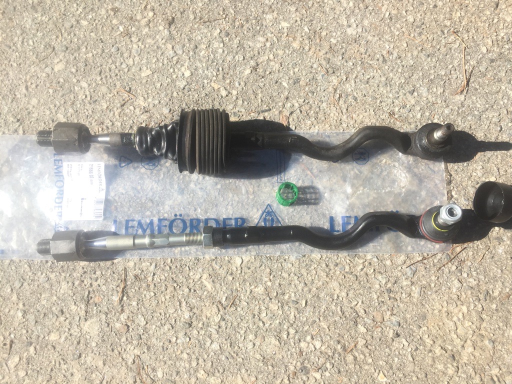

Tie rods are actually a fairly easy job with the right tools, but the tools make all the difference. A 34mm crows foot is nice for the inner tie rod, so it can be torqued properly, and a ball joint puller makes removing the old tie rod a snap. I stuck with those single use Oetiker crimp style band clamps. Having a set of offset Oetiker crimpers is nice when working on the tie rod boots.

I went with Lemförder tie rods. As far as I know, they are identical to OE right down to the same yellow and red seals.

It's not uncommon for the tie rod adjuster sleeves to seize. That's probably why they are so beat up. I little antiseize compound should take care of that

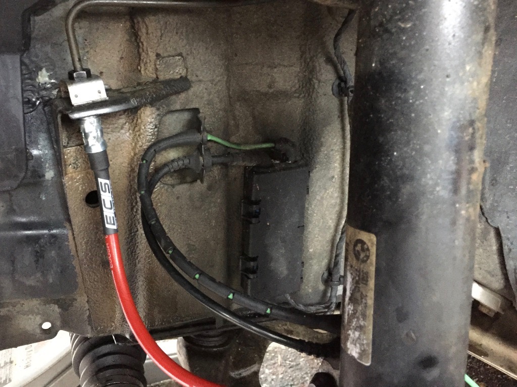

While I had the front lifted, I installed the new stainless lines on the front and did a quick bleed. If the rains holds, I may do the rear lines and a complete flush, today.
By cranking the car and pressing the brake pedal, then wedging the brake pedal down with a cloth-wrapped pipe against the seat, not a single drop was spilled from the hard brake lines, and I didn't need the vacuum caps. I placed a Motive bleeder bottle on the nipple and loosened it to remove the fluid from the old brake line before removing it. It made for a quick and clean brake line swap. While I was under the car, I replaced the quick-lock screws in the belly pan and replaced some of the clips that had rusted, and replaced the oil drain plug cover that was missing when I bought the car. And finally, I replaced the screw cover in the passenger side door pull. How people lose things like that is beyond me.
The ECS stainless brake lines are nice looking and appear to be high quality and well constructed
