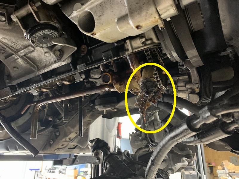

Next, rod bearings, we got quite the surprise when pulling the oil pan off.
https://live.staticflickr.com/65535/...a90995a2_c.jpg
Doesn't look like it caused any damage though. These don't appear to be the original bearings but with 186k miles it was peace of mind to know they are fresh.
