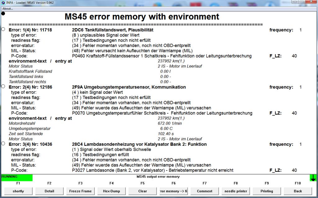

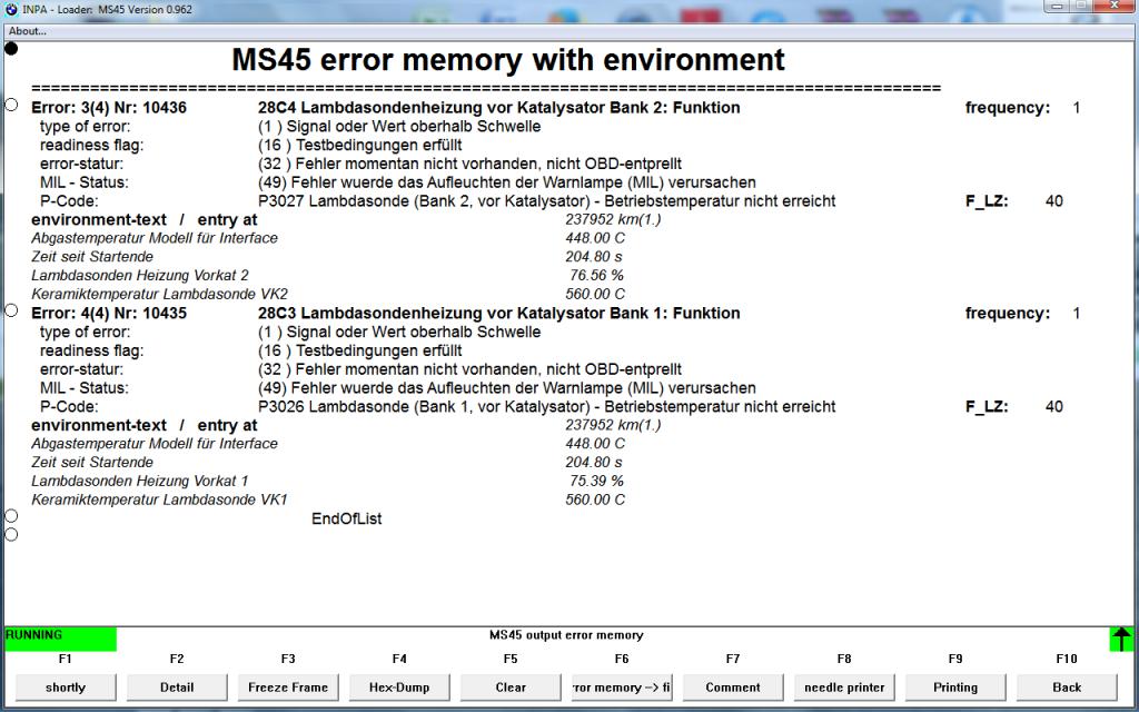

Here are the screen caps from INPA. Let me know if you think a singular fault is tripping all of them. Idle is loping and the engine is physically shaking when I look at it. My DSC and brake light are lit in orange at start up. It doesn't go away.
Attachment 12362
Attachment 12363
It definitely looks like the O2 sensors went...but why would it trip the other codes. I'm nervous about this whole thing.
I must have lost my ambient temp sensor on the way home...Potholes everywhere. The only problem is it doesn't say it's -40 or 122 degrees out.
So who has the best price for OEM Bosch pre-cat oxygen sensors??
Found some on Amazon for $42.00 ea. plus Prime shipping...Any chance local stores will have the genuine item?
Hard to be believe they both just go bad... In an instant?
That's what I'm thinking...but I will clean the intake track tomorrow and see if that works out.

Justin,
I had the front bumper off of one of the cars for a day or two, the ambient temp sensor unplugged, it threw all kinds of error codes because the engine didn't know what the ambient temp was to feed the correct air/fuel mixture. Try the temp sensor first, it may solve some of your other problems.
