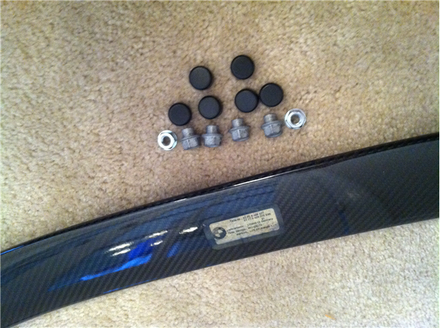

I just purchased an OEM M3 strut brace from Kijiji, and then realized that you need six special collared nuts for the install. They are $16.50 each at my local dealer. F^&*ing BMW!!!
Anyone have a set they are willing to part with at a reasonable price?
I think you only need four if it's the CF bar. That price is still crazy though.
Attachment 14300
It's the stock M3 brace, not the fancy carbon fibre one. It takes 3 of these special nuts per side, and then you are supposed to reuse 4 of your factory nuts to assemble the centre piece to the end brackets.
You seem to have four of the collared ones and two regulars - maybe all 6 should be collared?
