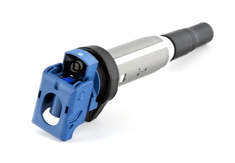

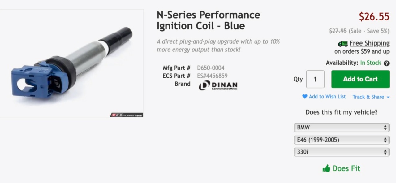

On my way home I noticed my engine running a little rough and the SES light on my instrument cluster as I was near my home so I got my Diagnostic Tablet to run codes and found a P0303 code and Cylinder #3 misfire. Also noticed Ignition Cylinder 3 fault called out. I was able to clear the fault, restart the car and allow the engine to run until the SES light came back on and then shut off the engine and read the codes again to find P0303 Cylinder #3 misfire and Ignition Cylinder 3 called out so I will determine if the fault lies with a bad spark plug or ignition coil. I have had bad ignition coils in the past and have a full set of used, but good ignition coils I can use temporarily to get the car running again.
I'm tempted in replacing all the spark plugs now as I have been planning to do this anyway. Then after the New Year I will order a full set of Dinan ignition coils for my ZHP like these below :cool
Attachment 39636
Attachment 39637
EDIT: I cleared the fault by replacing the ignition coil with a known good used ignition coil from my last ZHP I had stored in my garage and a new NGK spark plug.
I will be replacing my VCG and VANOS seals in February and at that time will be installing a full set of NGK BKR6EQUP spark plugs and DINAN ignition coils above :cool
