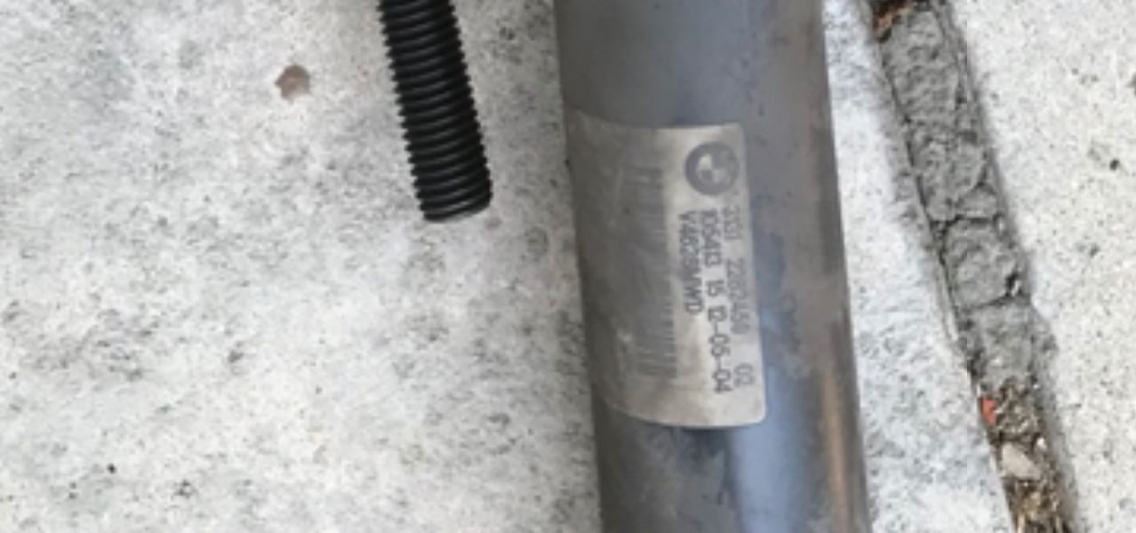

The TL;DR version is: M package cars (and by extension ZHPs) were praised for their amazing handling and ride quality, in part because they had Boge Turbo and Sachs Advantage shocks. The annoying part is that these shocks aren't made anymore! Well, sort of. The fronts became Sachs Advantage with the same part number and similar performance. Nice. But the rears became low performance Sachs Super Tourings. Yuck. They are 30% softer than the old ones according to ZF. So no good for my performance goals. ZHPizza also warned me against the FSDs for the same reason of lackluster performance.

Regardless of the downgrade, what's worse is that ZHP owners won't even find the M package shocks because due to how the part numbers are allocated, searching for ZHP (facelift car) parts will direct you to the post-2001 regular sport suspension for non-ZHP peasants. This is the case for pretty much all sites, be it FCP or Turner.

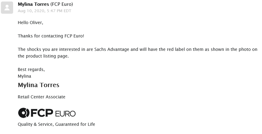

But if you search for the PART NUMBER as opposed to compatible parts, you will find that the current M package shocks, or MTech dampers as they are usually called (Advantage + Super Touring), are sold in America. On FCP, they only cost $330 for a full set!
Attachment 36993
(Pay attention to the red stickers, which denote the Advantage line, the high performance line for Sachs shocks. Low performance will have blue or white stickers.)
