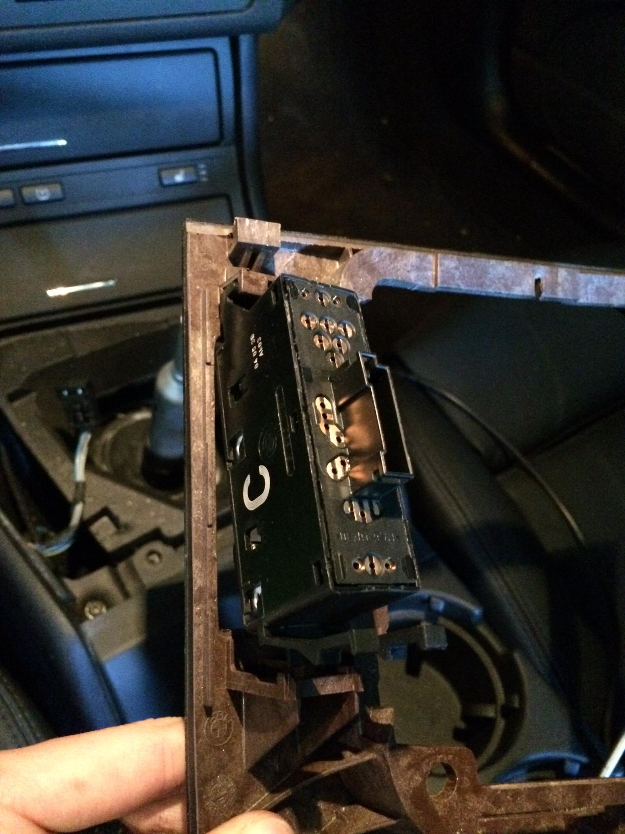

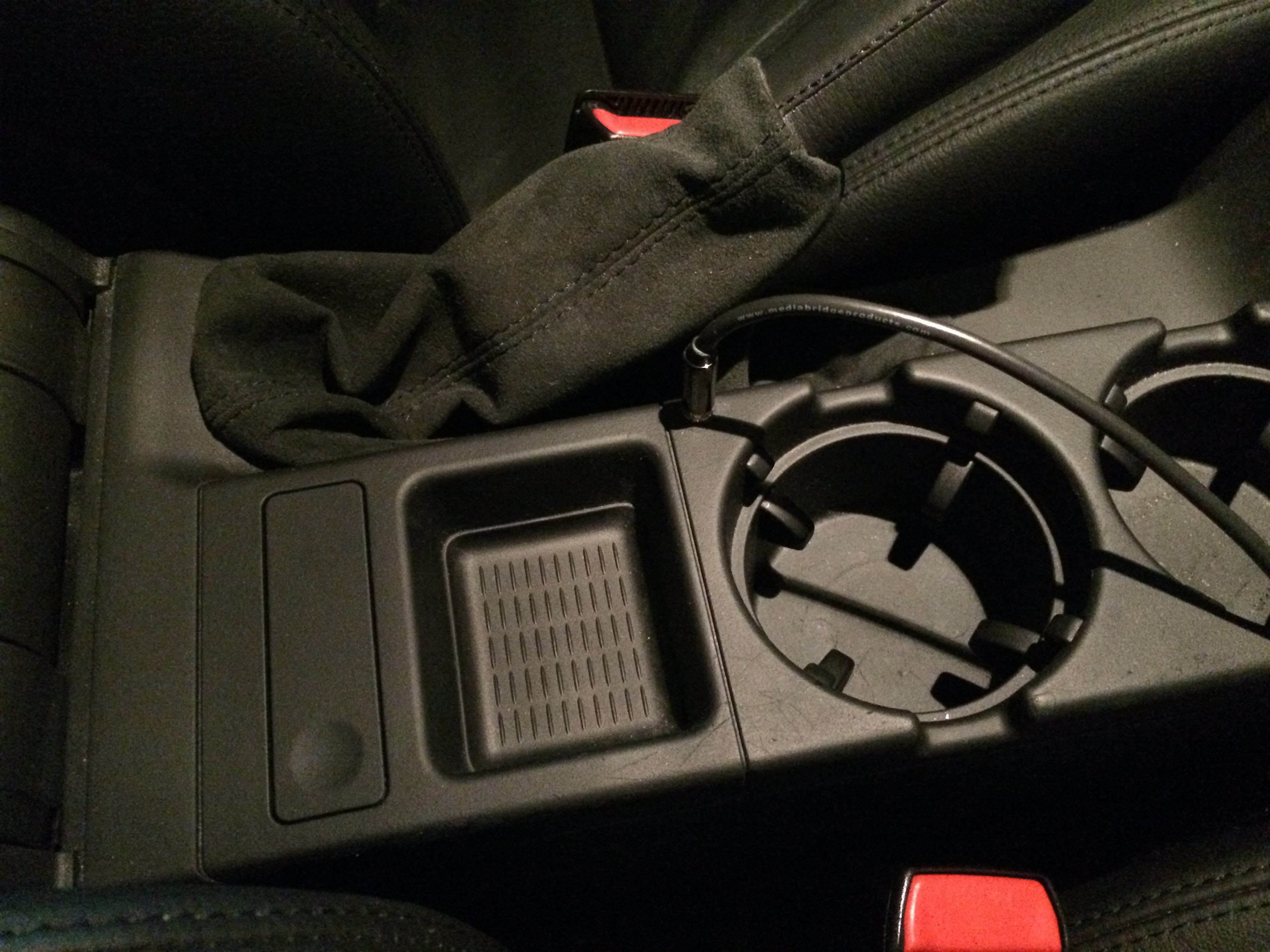

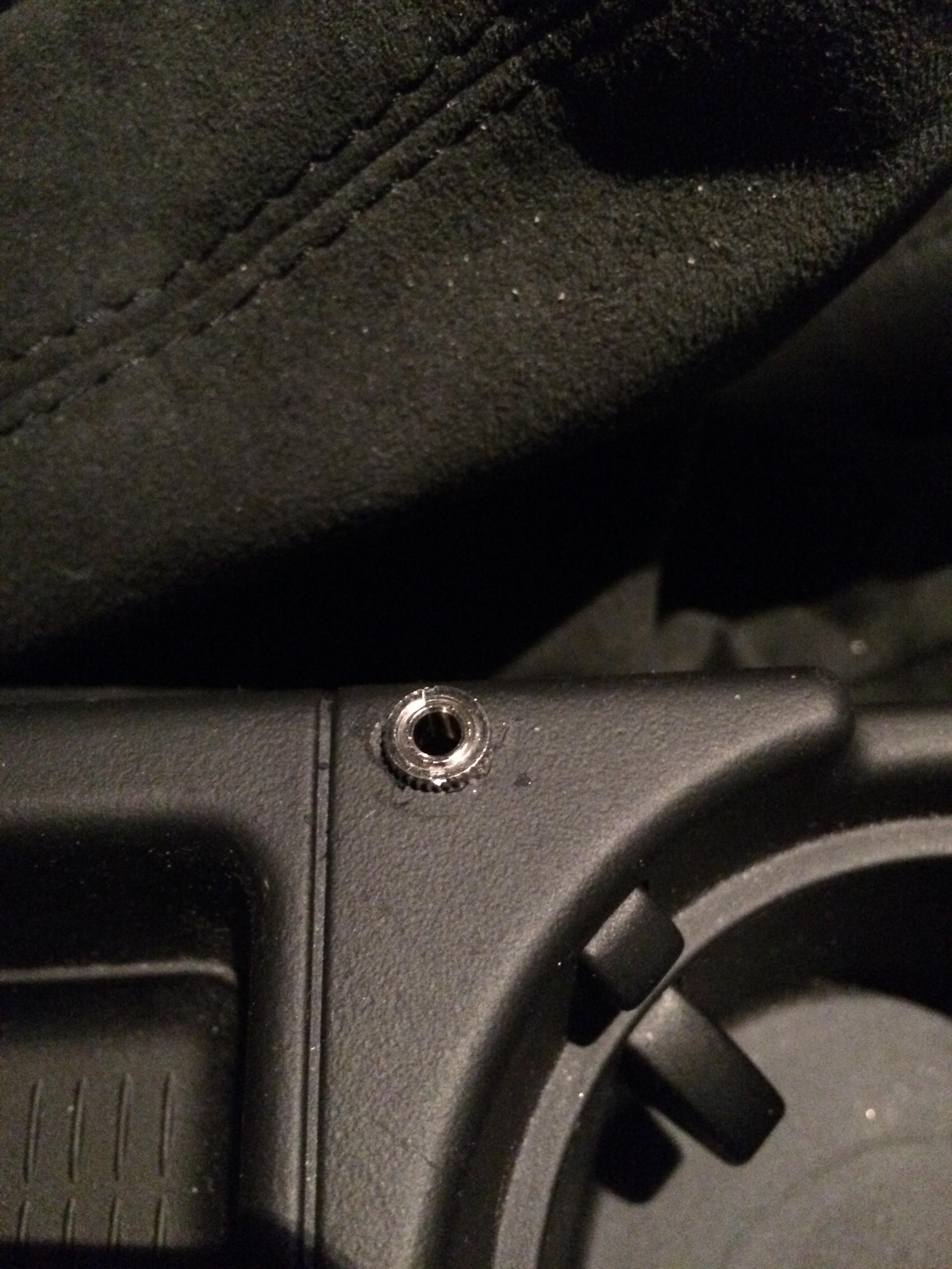

03/30/15 (49,547 miles) - Installed BMW OEM Aux Input in rear cup holder

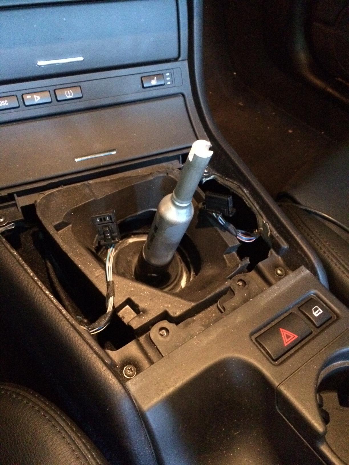

04/14/15 (49,682 miles) - Replaced OEM ZHP 6-speed shift knob

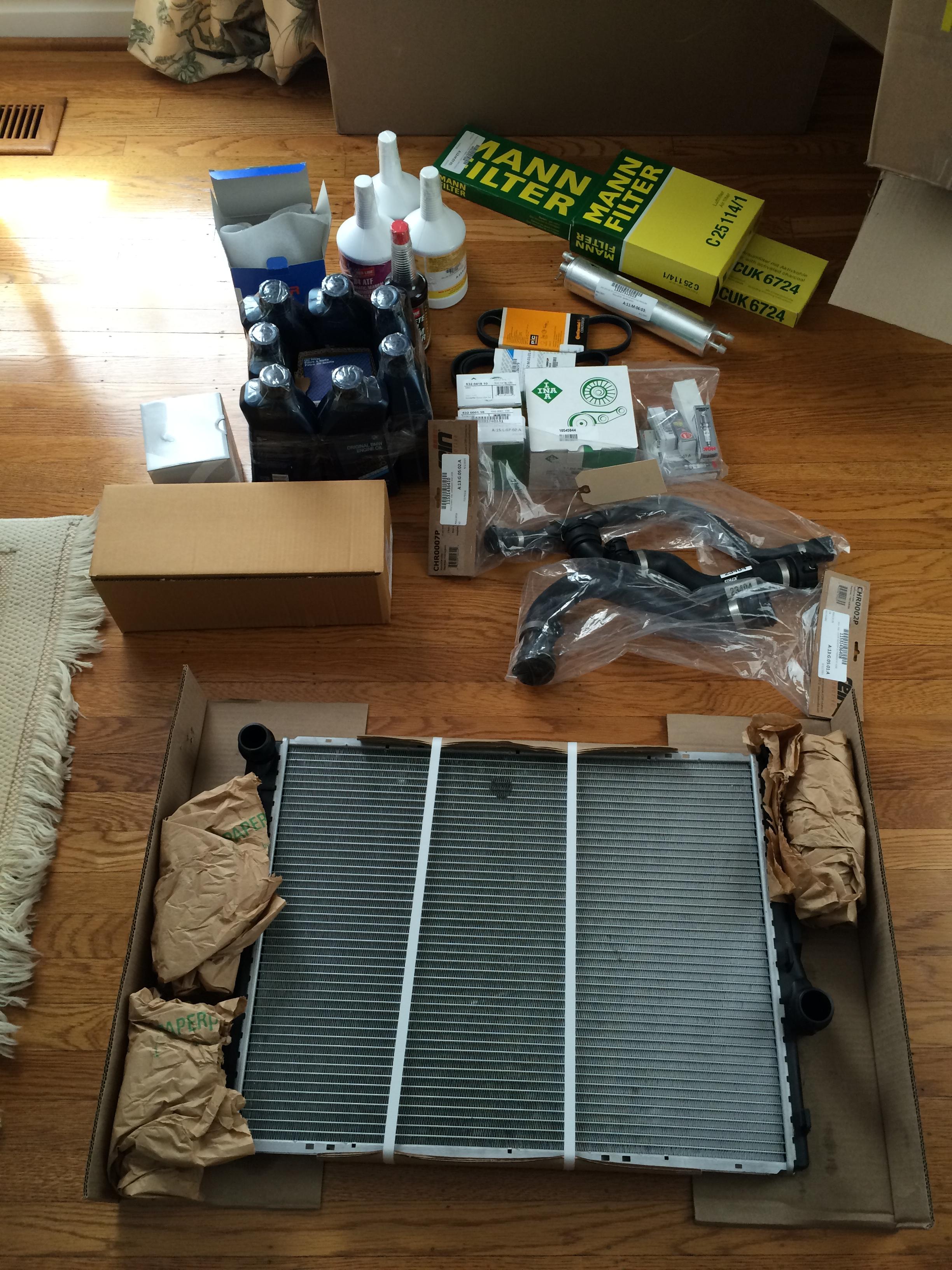

04/15/15 (49,682 miles) - Cooling system refreshed (radiator, expansion tank, water pump, thermostat, hoses, coolant temp and level sensors, coolant flush/bleed), replaced serpentine and AC belts, replaced idler, AC tensioner, and tensioner pulleys, replaced fuel filter, performed oil change (BMW 5W30) and new oil filter, replaced transmission fluid (Redline MTL), replaced differential fluid (Redline 75W90), replaced spark plugs (NGK), replaced cabin microfilter, and replaced air intake filter.

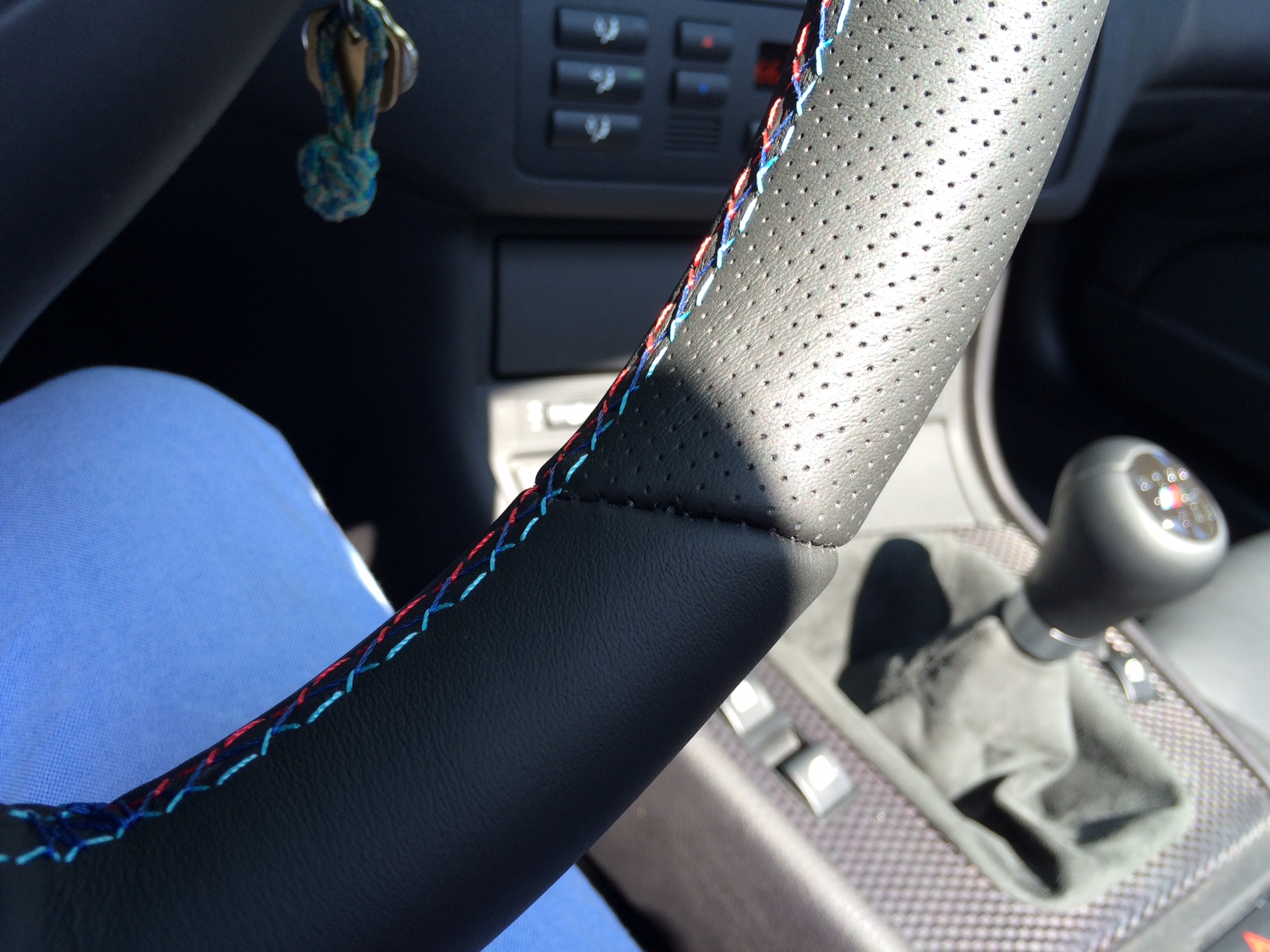

04/29/15 (49,844 miles) - Swapped out OEM alcantara steering wheel for leather/perforated steering wheel from DCT Motorsports

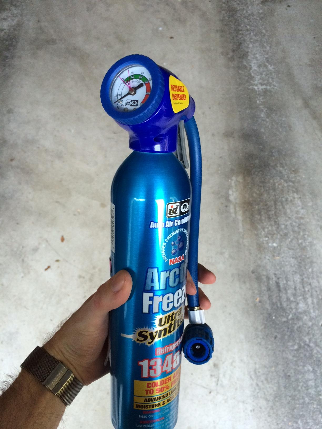

04/30/15 (49,858 miles) - Charged AC system

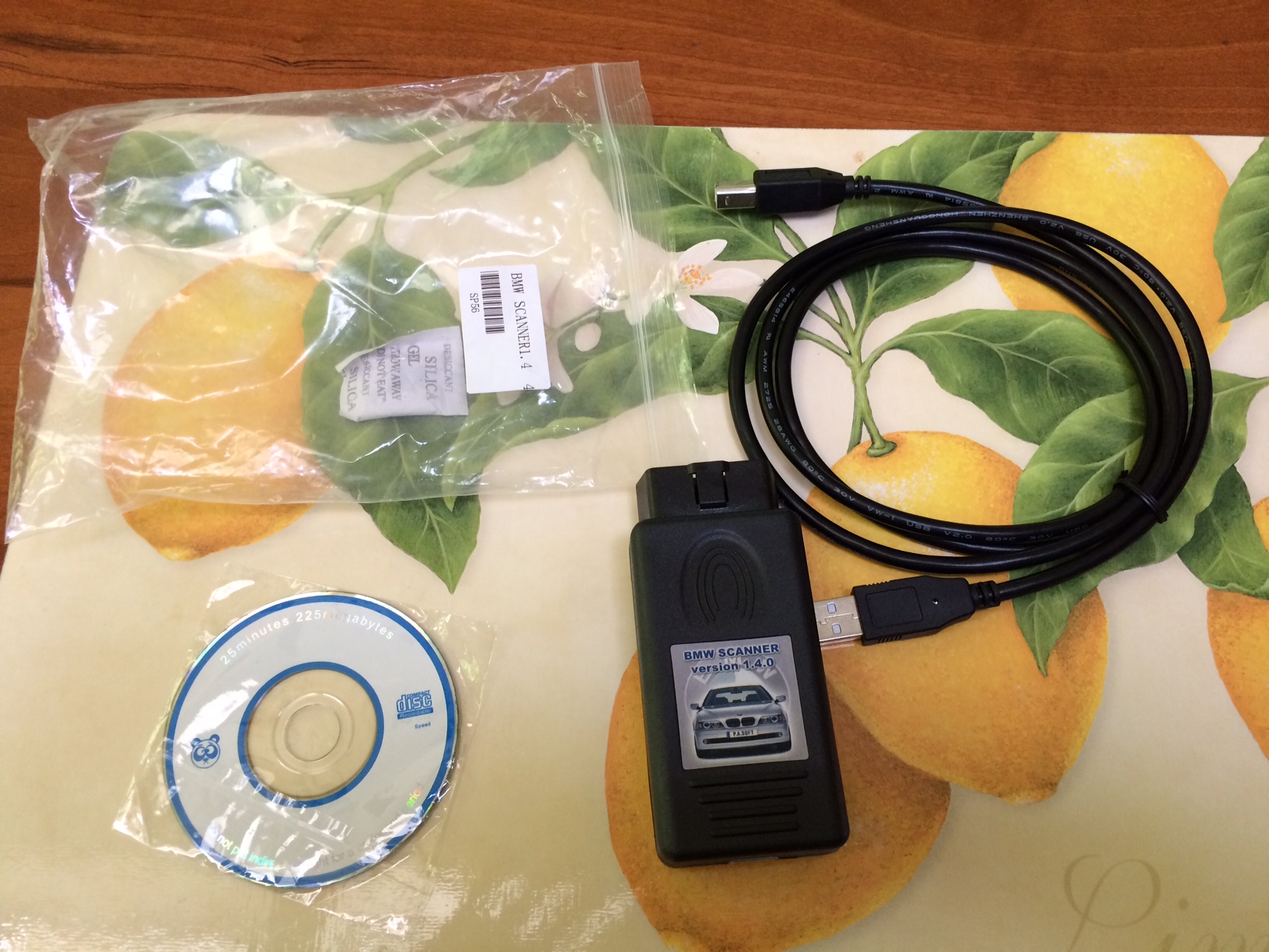

05/01/15 (49,909 miles) - Coded remote closing windows, one-click remote unlock, raised automatic locking threshold to 28 km/h, one-touch close rear windows, turned of daytime running lights using a PASoft BMW Scanner.
05/02/15 (49,914 miles) - Completed one-touch close rear windows modification

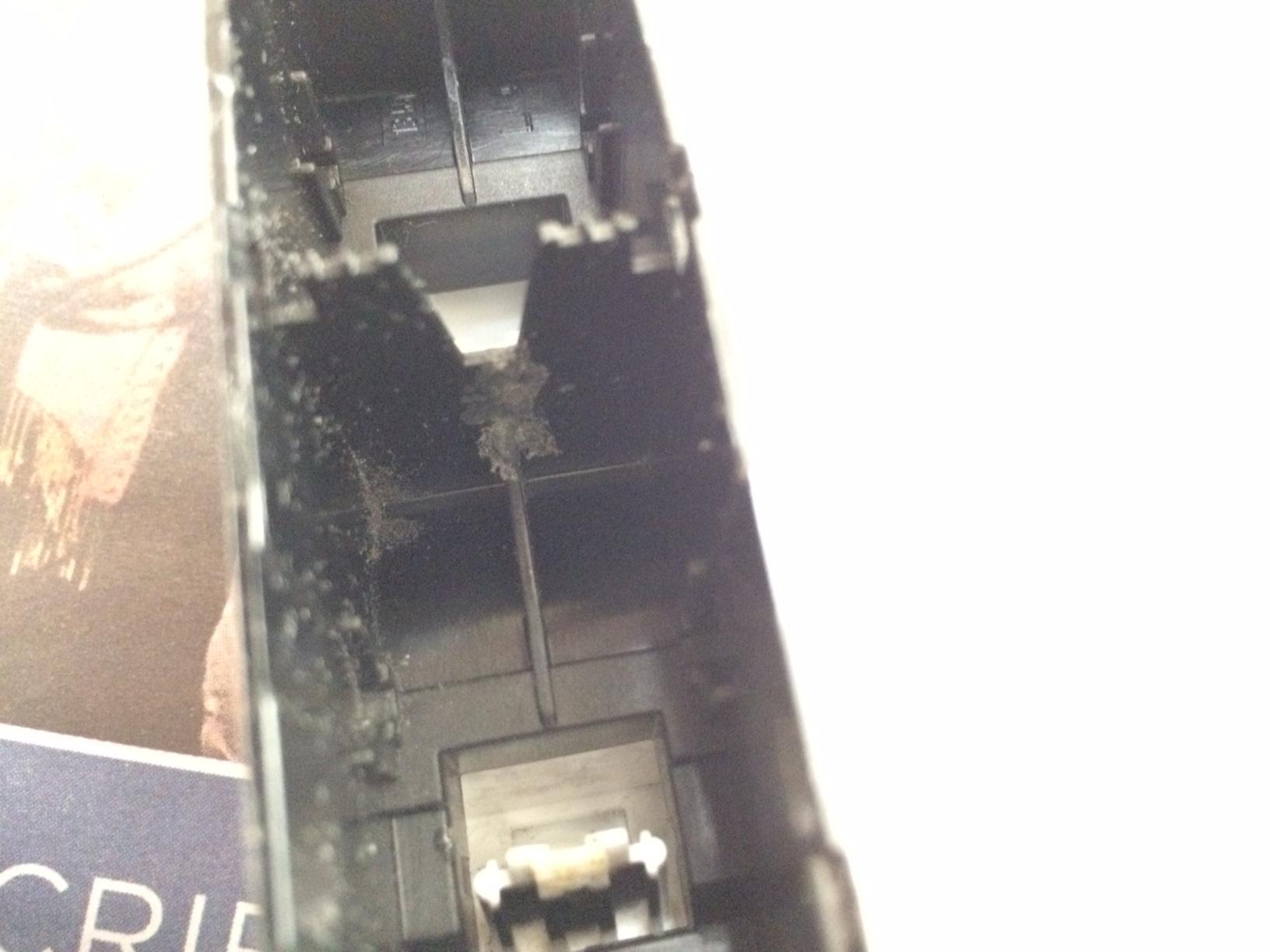

08/13/15 (51,012 miles) - Installed wheel pin tool in the trunk toolkit, replaced driver's side window switch button, replaced windshield washer pump
08/25/15 (51,140 miles) - Coded the temperature gauge for more useful values

12/26/15 (52,788 miles) - Swapped alcantara shift and parking brake boots for leather boots

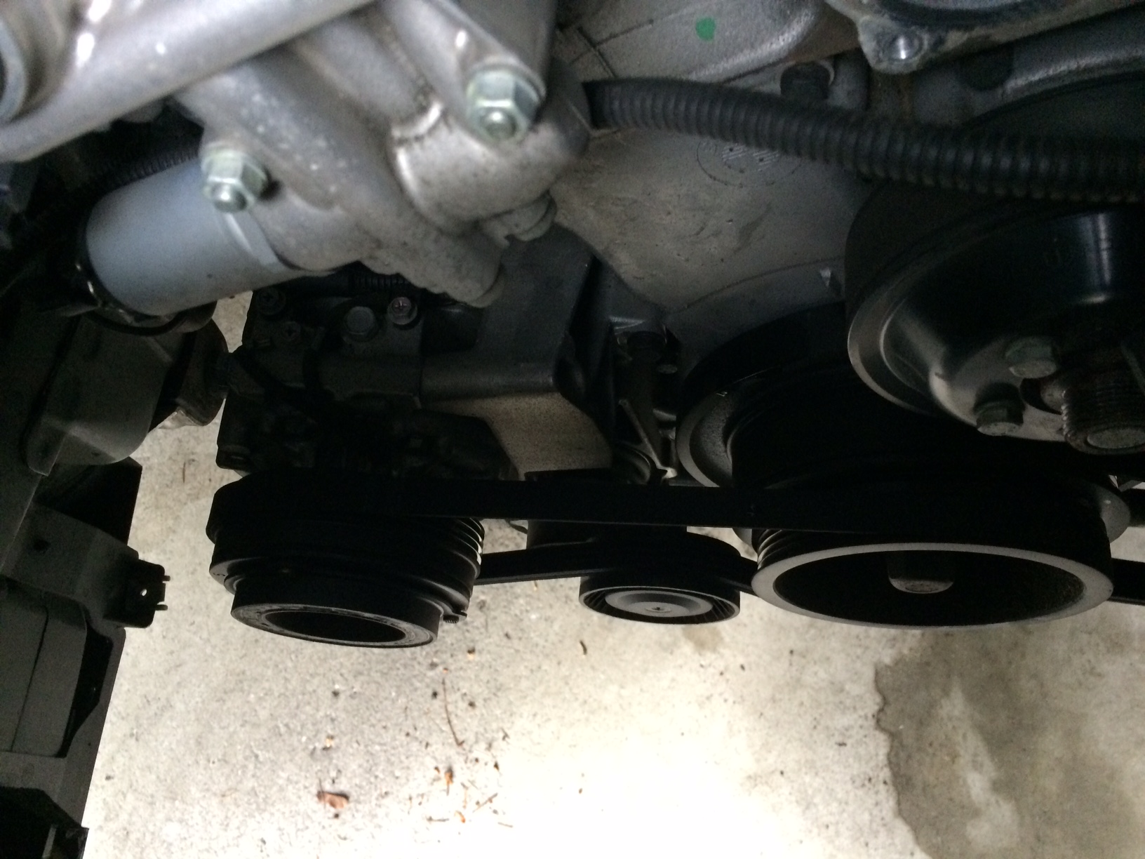

08/22/17 (56,957 miles) - Replaced factory plastic water pump pulley with an aluminum pulley

01/11/18 (59,869 miles) - Installed Turner Motorsport Power Pulley Kit

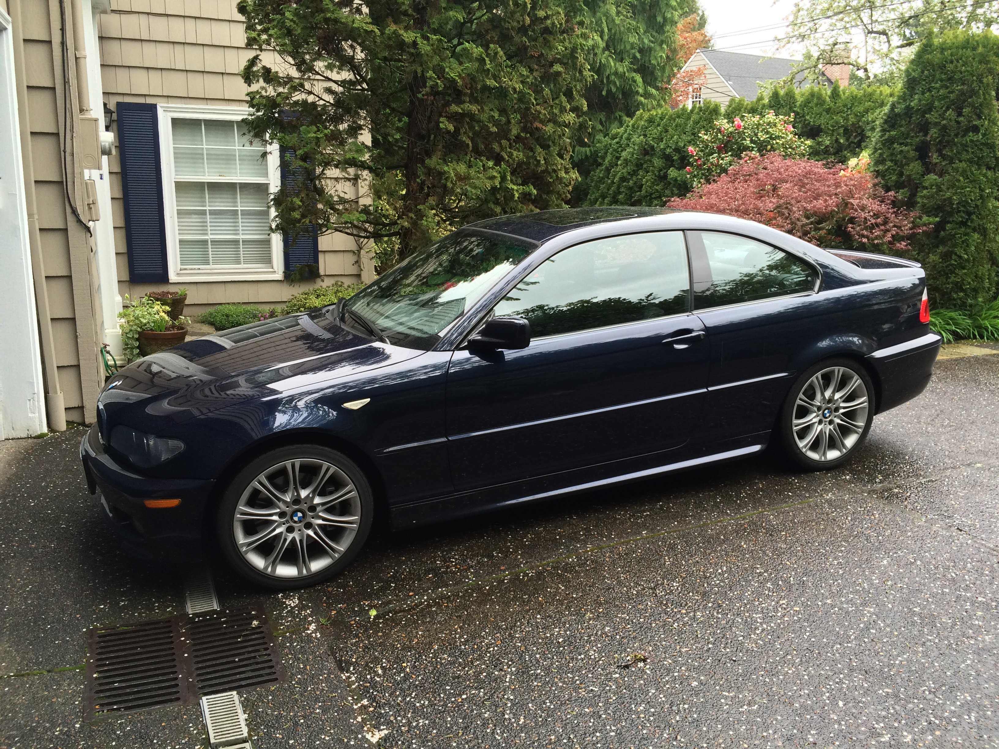

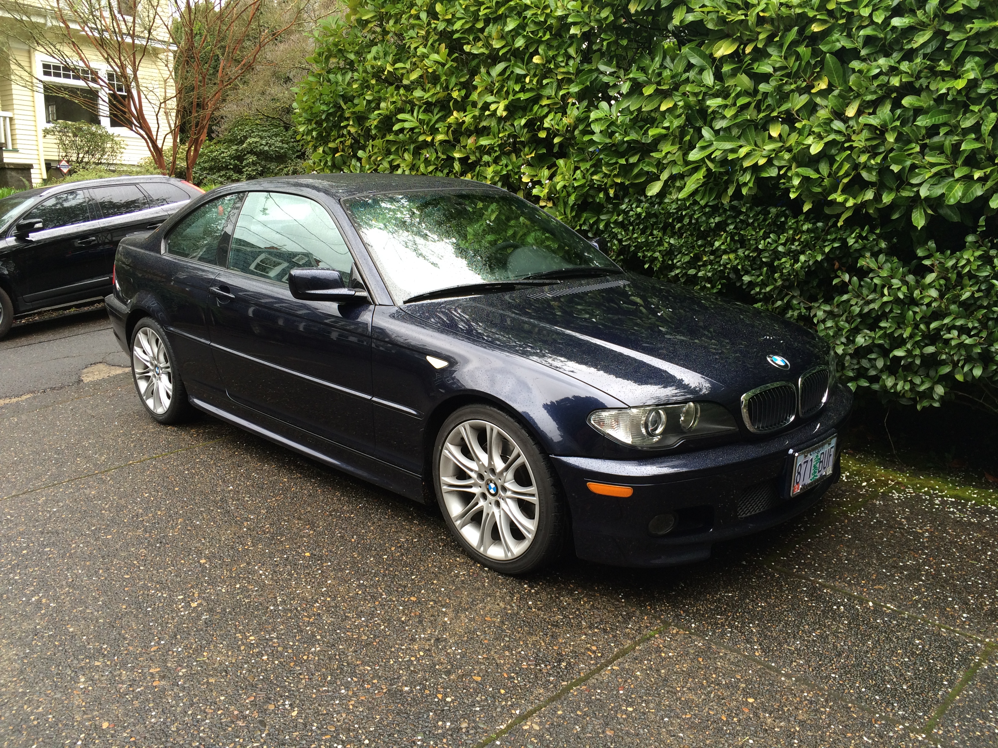

Some pictures from the first couple of days after I bought it:
Attachment 19081Attachment 19082Attachment 19083
