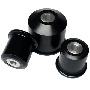

i think there are folks that say that poly in the rear diff mount location creates a lot of audible diff whine in the cabin. but rubber wears out fast.
personally, i'm trying the poly bushing. i bought the ECS-branded unit as it was on sale and appears to be of a soft durometer.
peter
AKG Bushings. Recommended for street or performance use.
Attachment 19825
are you running those, vas?
I run AKG FCABs & RTABs. Very happy with them.
