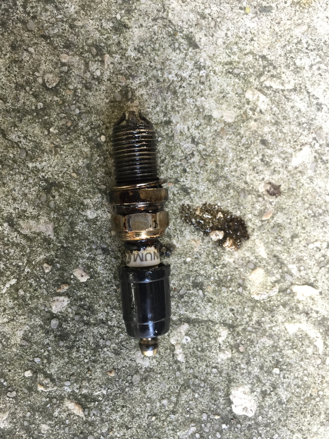

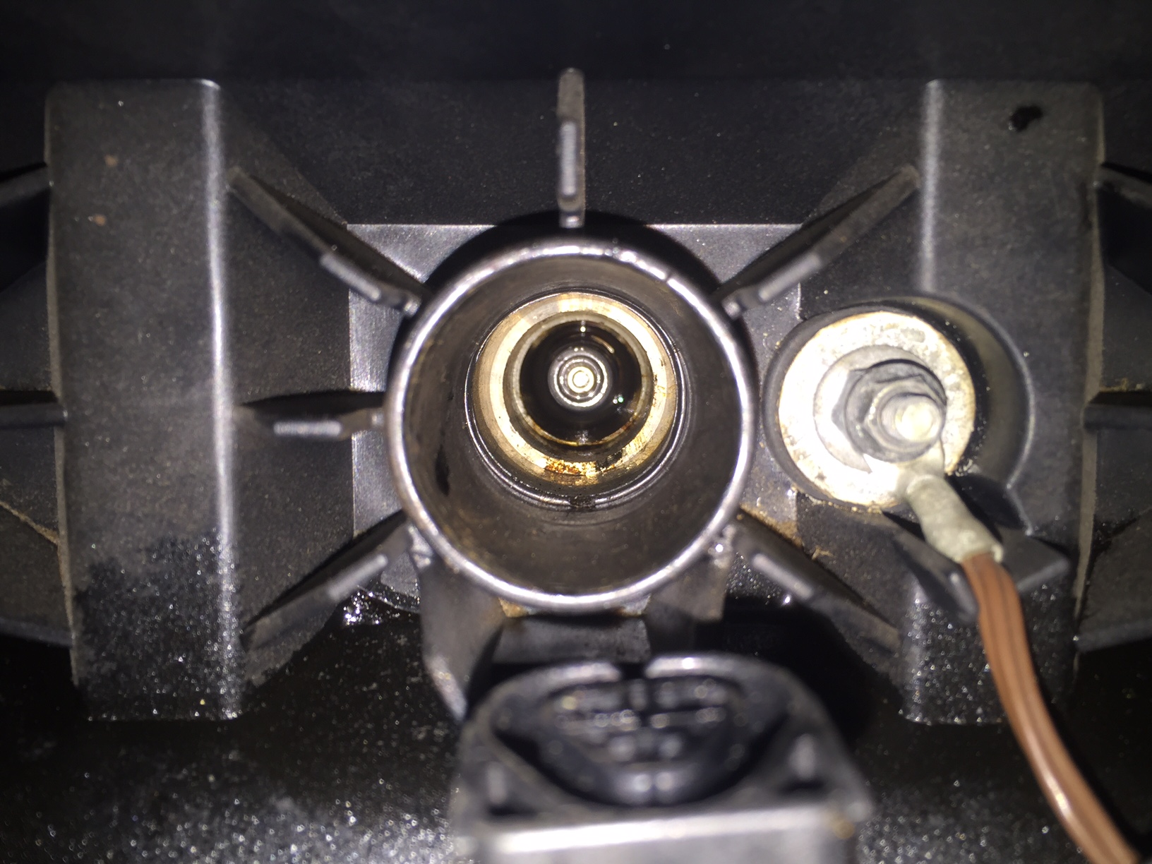

Encountered a problem today while changing the spark plugs on my ZHP. All the other spark plugs came out fine except for cylinder #3 which is stuck. It takes a lot of force to barely get 1/4th a rotation in the right direction. I sprayed some WD-40 down there and tried again, which seemed to help at first until I just couldn't get the wrench to move at all. Just sprayed some PB blaster down there and currently letting it soak. I think the problem is that the hex head of the spark plug is broke off. I'm not entirely sure what to do at this point, would warming the car up a little bit help? I don't think that would be a good idea though since I sprayed WD-40 on the plug...
Attachment 23516
Cylinder #3 spark plug stuck
Small victory but on to the next problem, waiting for a coil pack to come in because cylinder 1 is shot. Also noticed my coolant was empty, leaking out somewhere despite my indy just replacing my waterpump and thermostat in October. :facepalm Also had a small plume of smoke come out of my exhaust on startup after putting in the new plugs, is that normal? Burn off of excess oil? Never happened before.
