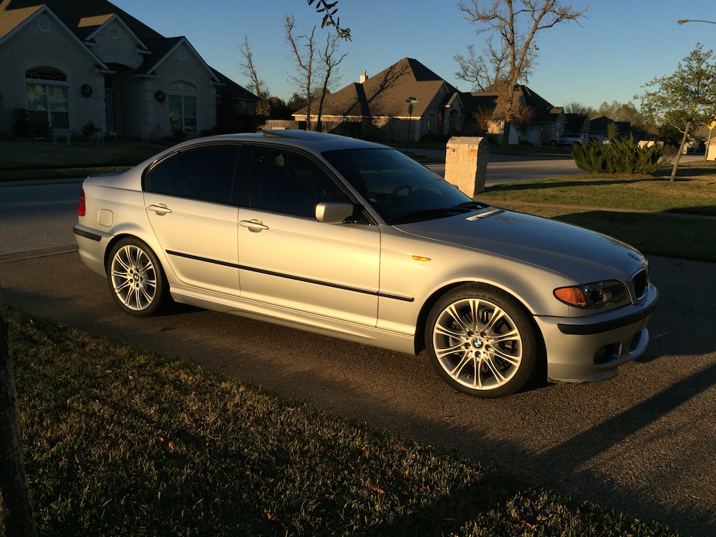

Time to consolidate my posts into a single thread so I can keep track of things. In November 2015 I purchased a 97k mile 2005 ZHP 330i 6-speed hoping that it could serve as an excellent daily driver, school bus to get my two kids to kindergarten, and occasional track/auto-cross weapon. I'd seen great things with the Spec e46 SCCA class, and was confident this chassis could meet those goals within my budget. I purchased a titanium silver over black alcantara from Supreme Auto Imports in Florida after an encouraging PPI.
The experience was painless and I've been very pleased with the car. The PPI indicated that the VCG and OFHG would need to be replaced soon which I took care of ASAP along with a preventative cooling system rebuild. Here's the full list of maintenance and mods I have done thus far...

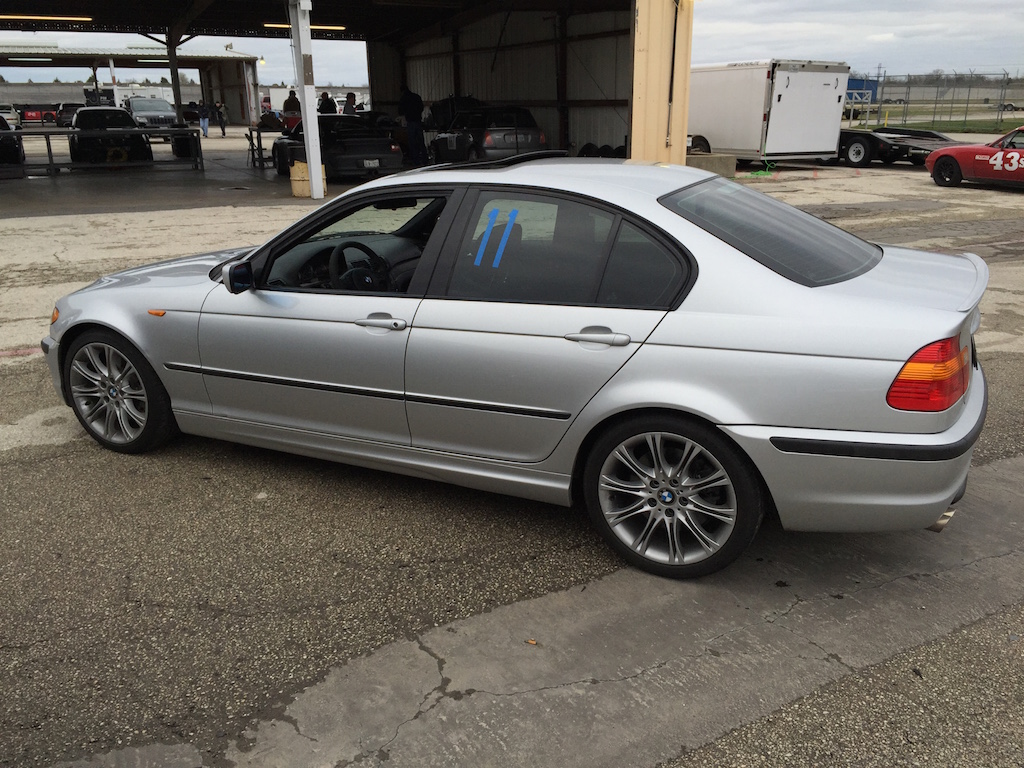

Jan 2016 (98400)... First track day in ZHP! Ran 4 sessions. Car ran flawlessly

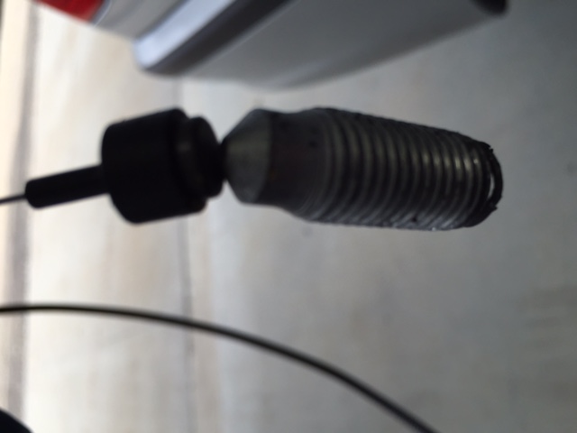

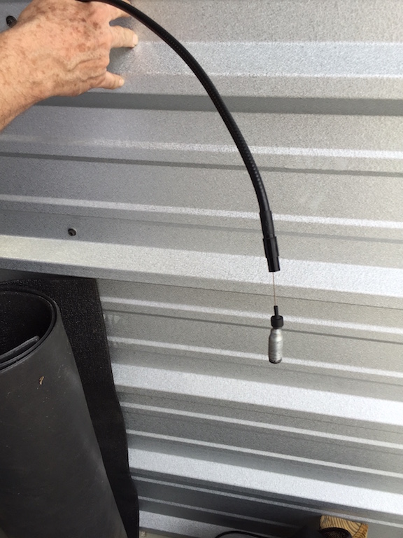

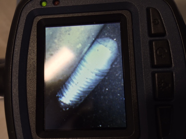

Jan 2016 (99000)... Scoped inside of chassis near subframe mounts to confirm there are no cracks and to verify that BMW installed reinforcement blocks in post 10/2004 e46's

June 11-12 2016 (102000)... Second weekend at the track in the ZHP - just keeps getting better!
