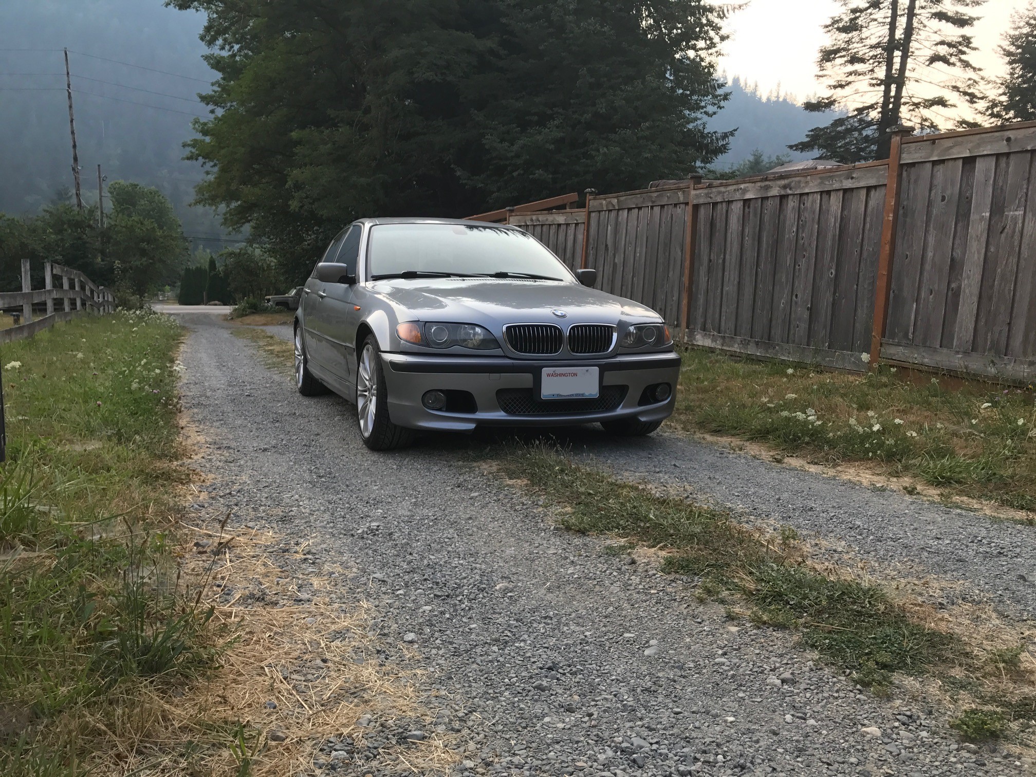

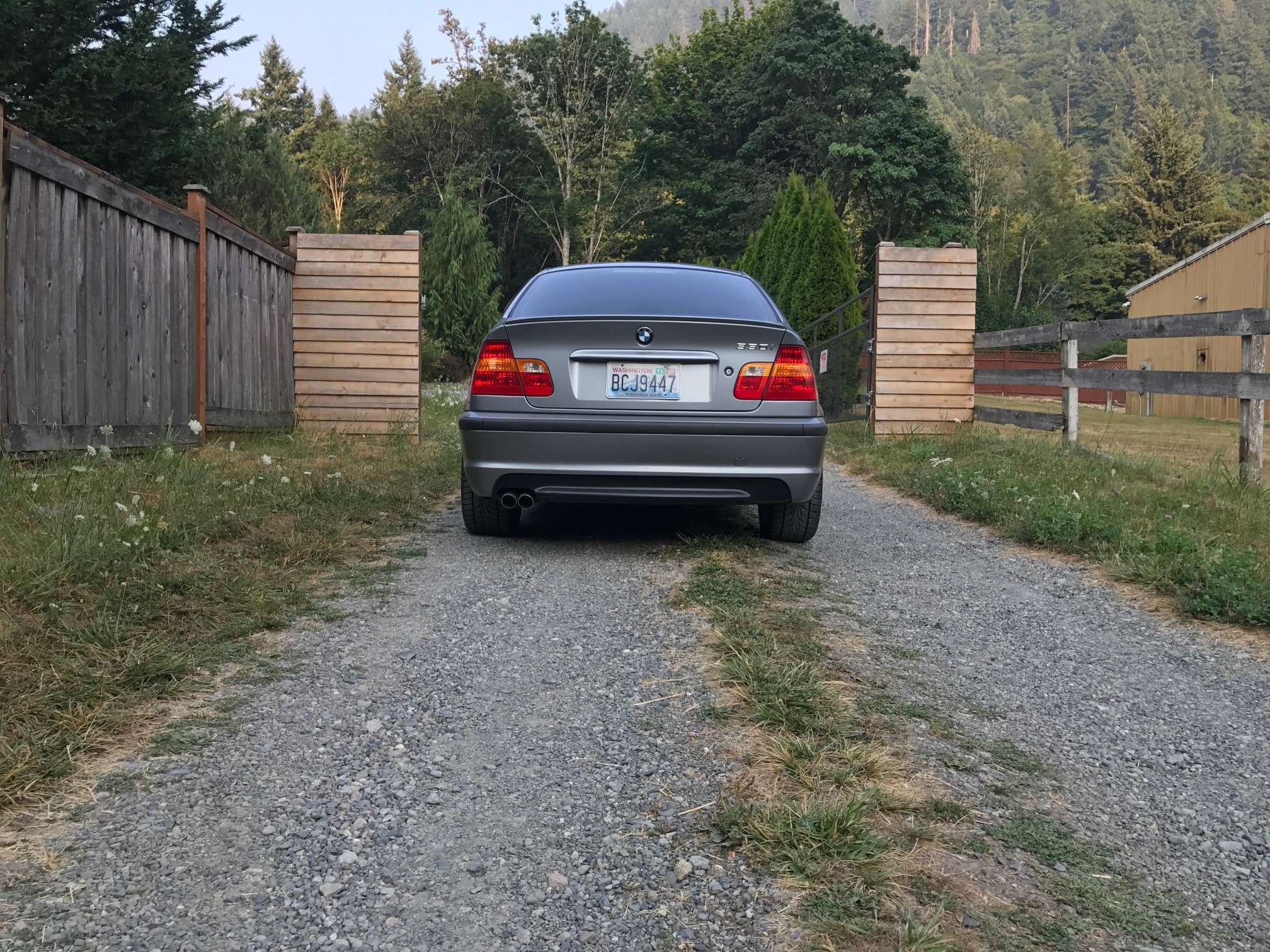

I am adding a new member to my BMW stable:
Welcome the Martlet, a 330i ZHP sedan with 109,000 miles on the clock.
Some appearance flaws that need addressing:
1) Bumper Alignment
2) Driver's Side Black Plastic Molding Alignment
Wouldn't be a project without some issues and outstanding maintenance. The car came with nothing more than a title, so in the coming weeks I will be addressing some of the maintenance items:
1) Oil Change + Filter
2) Wheel Alignment
3) Rear Shocks
4) Shot AC [Fixed with a simple R134A Recharge]
5) Check mounts and bushings
6) Exhaust leak (Where is the most common place?)
7) ABS/Yellow Brake Light (Sensors?)

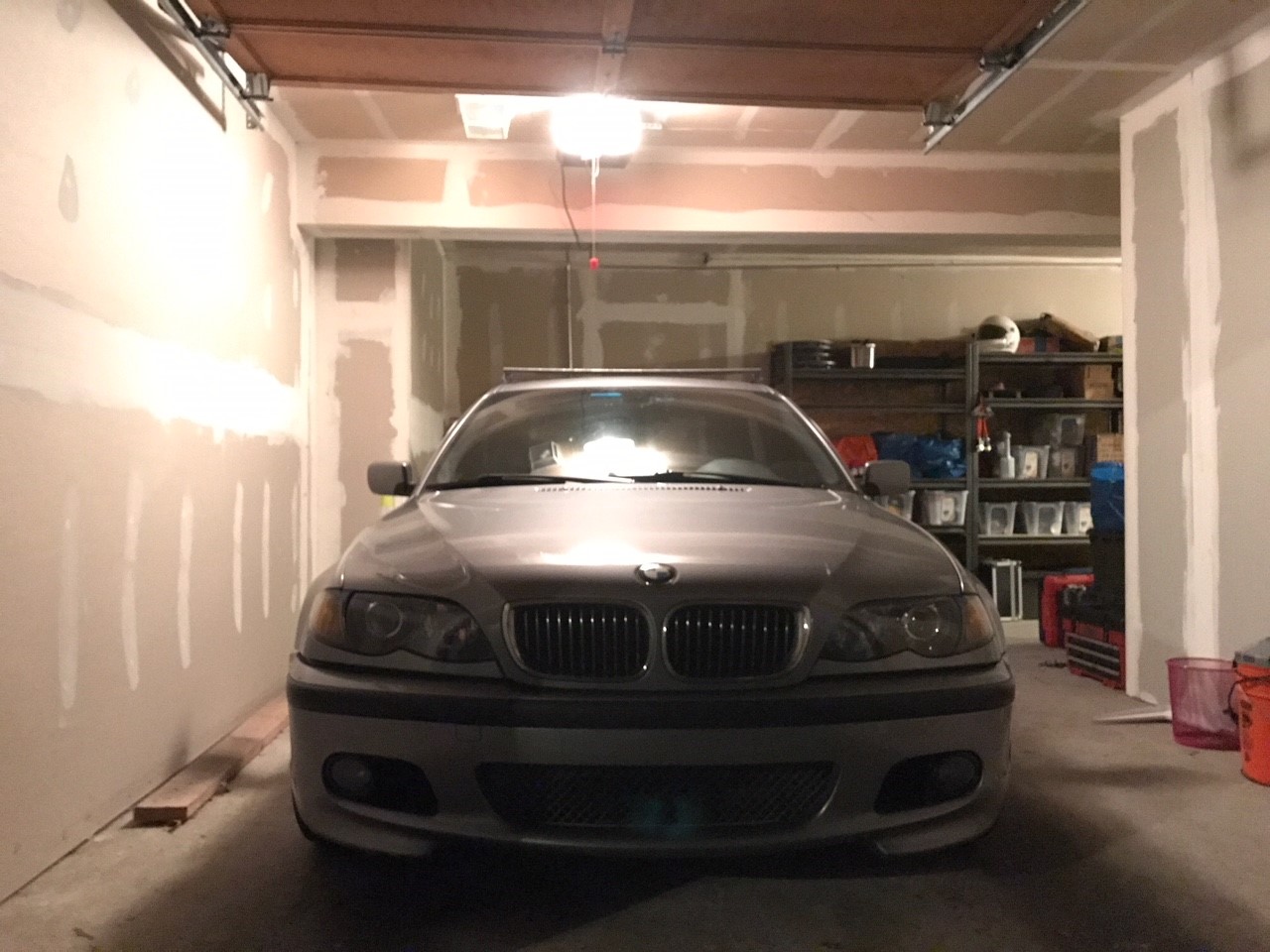

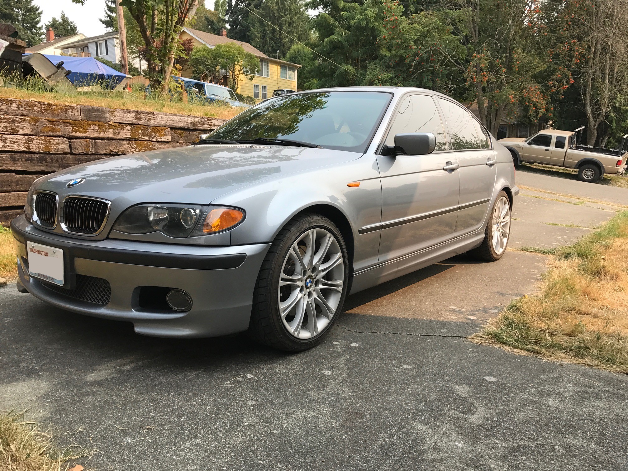

Some pictures for your viewing pleasure.
Attachment 30744
Attachment 30745
Attachment 30735
Attachment 30736
Attachment 30737
