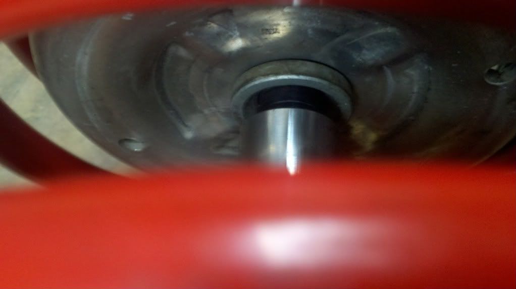

- pull back the trunk carpet (I cut holes in it to allow easy access to the adjuster)
- unbolt the top shock nuts, have a friend catch them or try to do it yourself.
Telescoping magnet is a good safety here.
http://i1015.photobucket.com/albums/...013_162714.jpg
- bolt the new shocks in on top
- insert the spring & rear height adjuster
- jack on the knuckle where the lower shock bolt bolts up until it lines up to re-thread that lower bolt
- make sure the spring/perch stay aligned with the nub in the body as you jack it up
- put the wheels back on, you're done!
If your newer suspension is lower than the old one you won't need a spring compressor to get the top mount back on the strut. Good luck!
