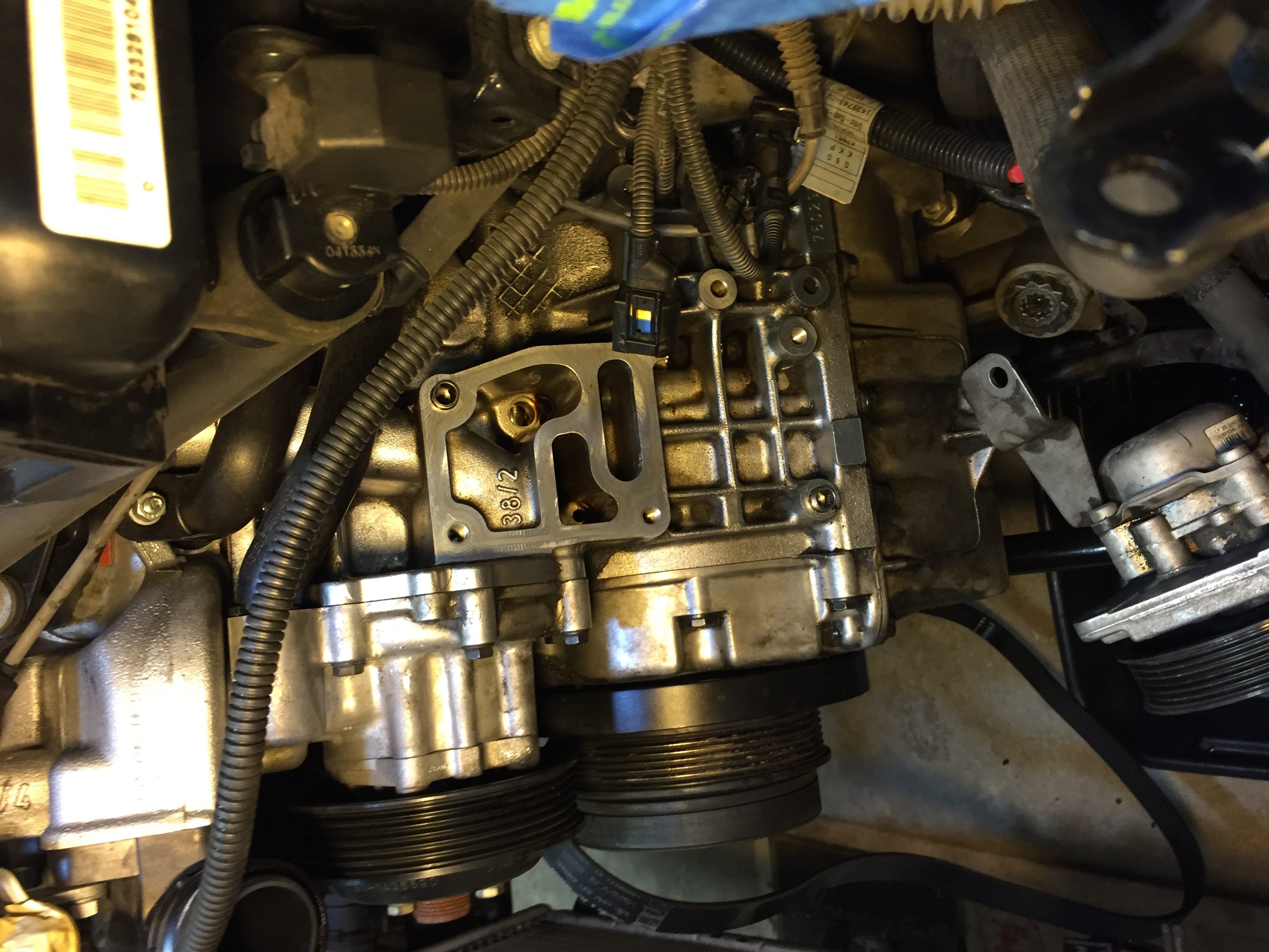

    I then changed the OFHG following both Pelican's DIY and the e46fanatics DIY. The process was straightforward. It definitely helps being able to remove the upper radiator hose and expansion tank first, providing lots of room to work. This was an ideal time to clean the driver's side of the engine. Reassembly was easy, with the exception of the alternator which was a bear to line up! A light-weight rubber mallet proved very helpful here (nothing heavy - you don't want to do damage). Install the lower alternator bolt first but don't tighten it. Then use the handle of your mallet to pivot the alternator slowly until the top bolt lines up. Here's a pic with the OFH removed.
