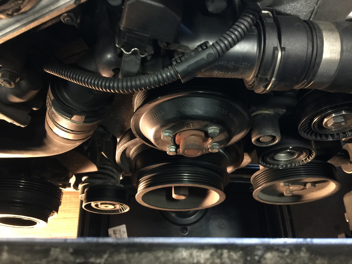

    Step 2.) Pop hood and photograph your Belts. This will help the belts go back on properly. Also, loosen water pump pulley bolts!
    Step 3.) Remove belts. I used a small metal pry bar to push down on the hydraulic tensioner to remove the main belt. AC belt was removed by using a socket on the tensioner pulley. (14mm or 16mm, I forget)

    Very simple tools required for this job. I chose to use new hardware, but reused the water pump pulley. The pulley is plastic, so be careful working around it. Mine was in good shape, just needed a cleaning.
  7. #137

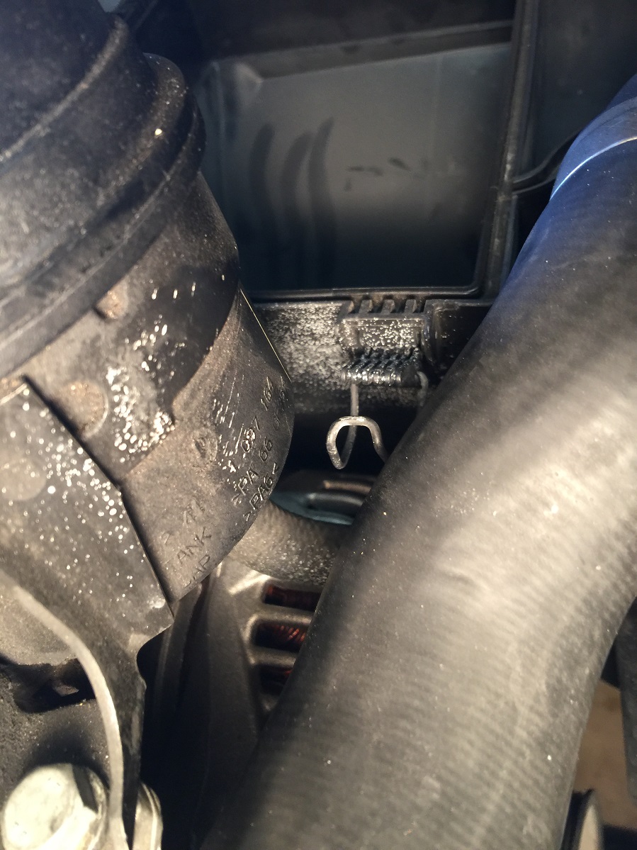

    The old water pump. Look at that stalactite!! One of the common failures with these water pumps, is the weep hole. That is were mine failed. Coolant will slowly leak out and it may be hard to spot at first. Look for white splatter spots near the air box.
