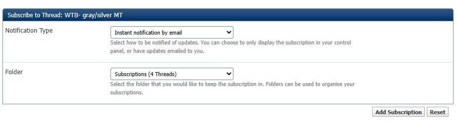

    I don't see the above screen on my side. Are you using Tapatalk? This is how I subscribed on the desktop version:
    1. Open thread
    2. Goto Thread Tools > Subscribe to this Thread
    3. This screen shows:

    That is how mine is set too. I actually got locked out of my account messing with some settings yesterday. Dane got it reset this morning and maybe thats fixed the email notifications too.
