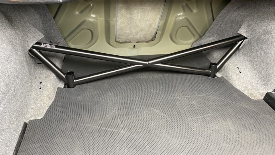

    Finished product.
    Since the X-Brace locks the rear mounts into place, it also protects the front mounts. That being said, only the non-folding sedan and convertible have reinforced front subframe mounts, so unless you have one of those two body types, it would still be a good idea to install front reinforcement mounts like those found in the Vincebar kit.
