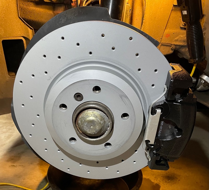

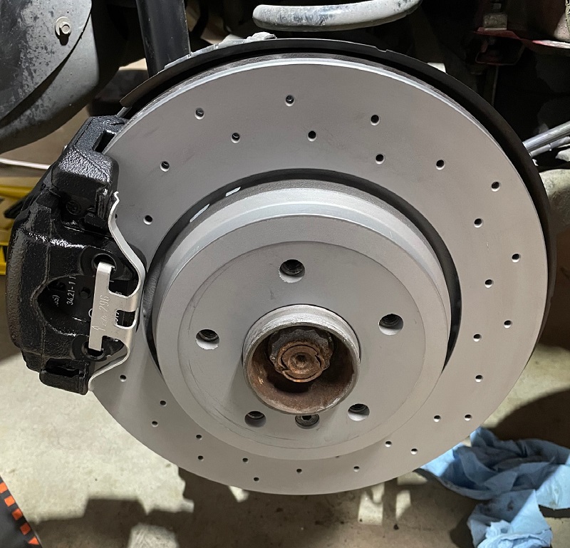

    I just finished overhauling the front and rear brakes on my recently acquired ZHP. I replaced the front calipers with ATE remanufactured ones and cleaned and repainted the rears. All new ATE bushings, guide pins, rubber brake lines, Zimmerman Sport rotors, BMW brake pads, parking brake rebuild both front and rear.
    I also painted the calipers and carriers semi gloss black like the E46 M3.

    Looks good! Maybe I should get around to painting my calipers, but I'd want to find something that really withstands heat since mine get hot at the track.
    Handbrake rebuild is also nice, when I did mine the shoes had no friction material at all. So now my handbrake actually works lol

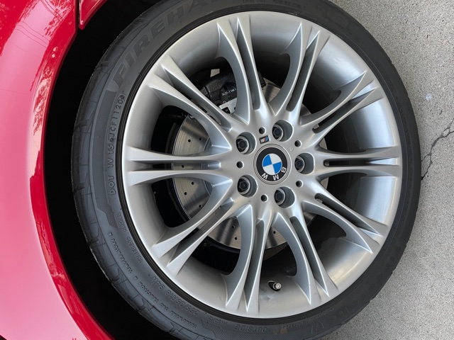

    Yes, no track on mine but I repainted my calipers with the same paint in 2015 on my other ZHP and they still look great. the key is a good cleaning and two coats, letting it dry between coats. Yeah my handbrake shoes had plenty of material but they had gotten hard with age and not holding as well is it should. I figured I was in there and do it all. They look tremendous behind the wheels because it's still a stock-ish look. It was a lot of work but they look great. i also replaced all the bolts so feel better on fresh brakes. These Zimmerman Sport rotors are awesome for a single piece rotor. They look great and feel stops just like OE, same bite etc. They are hard to find but worth the effort. Great rotor still made in Germany.
