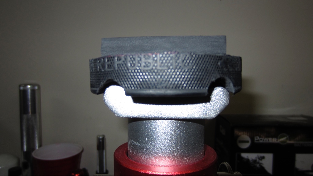

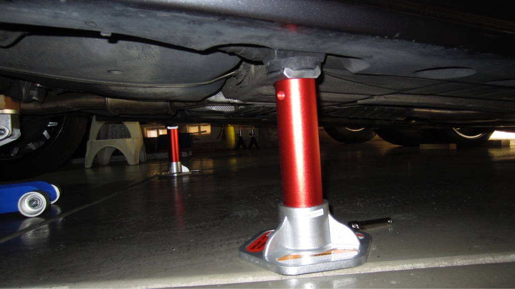

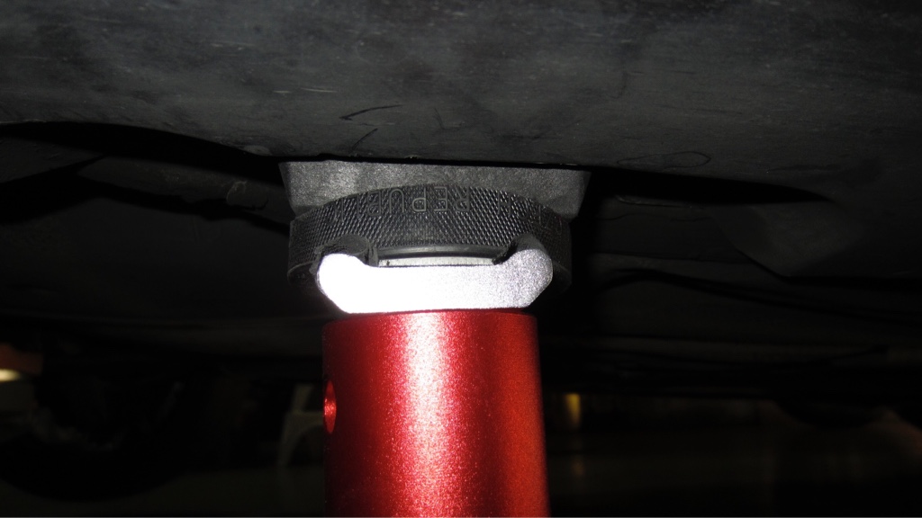

    I have the Torin 3 Ton Jack Stands. I also use the modified hockey pucks.

    Interesting the modified hockey puck!
    I 'll throw it out there I'd suggest to not use Chinese made pucks (yours say Czech Republic). I've seen many of the Chinese made pucks break even at 12 and under age levels. I can't imagine them being safe in this environment.
