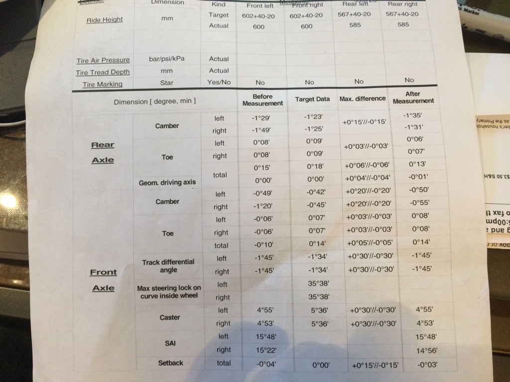

tire rotation: done. Front tires showing a little inner wear they they said. Tires are almost 10k old
Alignment: A few numbers seemed off but the tech specifically noted that he suggested replacing both upper support bearings and redoing the alignment, and caster being a degree off on both sides (but completely even). Also noted the wishbones and CABs look aftermarket. Not sure if those would have an affect on caster (thoughts from our resident suspension experts?). I can always add new OEM parts to my list for when I do my suspension refresh.
Picture of alignment:
Attachment 16452
