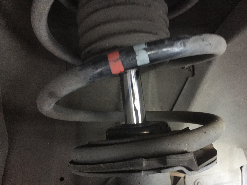

I went to the pull yard, but if this one is no good I'll definitely be asking you. Donor car was an '03 325i sport.
