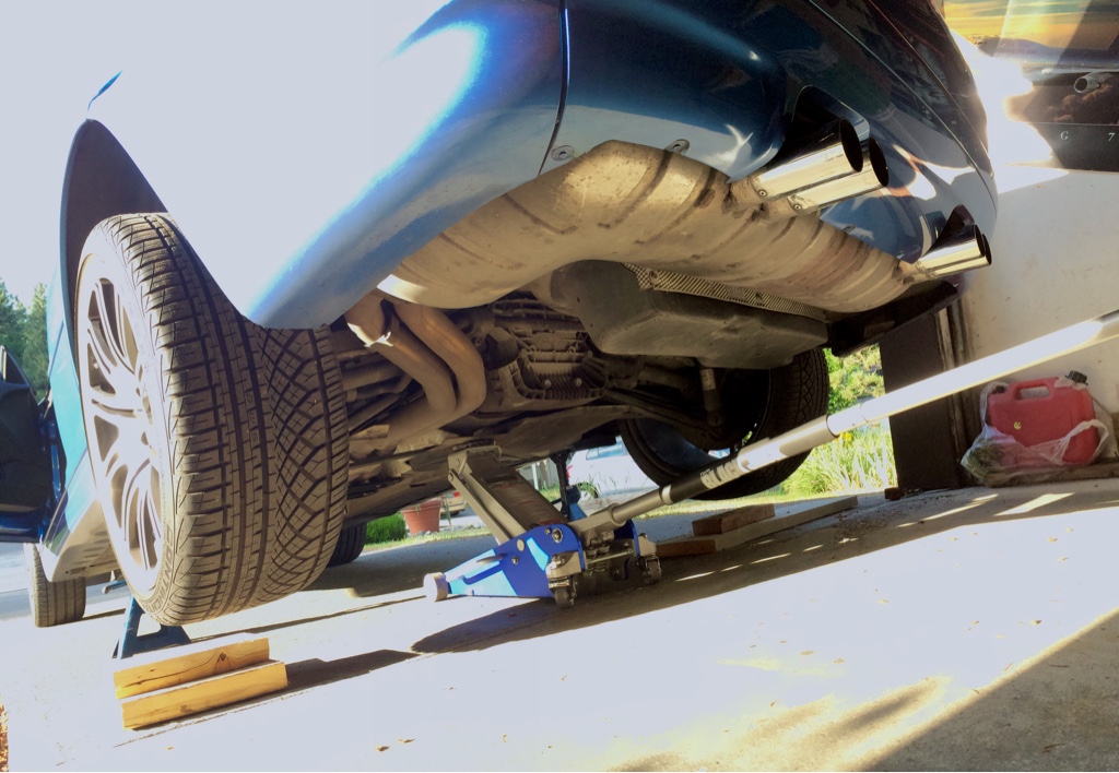

Since Alex was doing his rear brakes. I decided to do mine. Just did the full parking brake adjustment from the annoying turny knob inside the rear rotor to the cable adjustment on the interior lever. Doing this is much more tedious with an LSD!!
