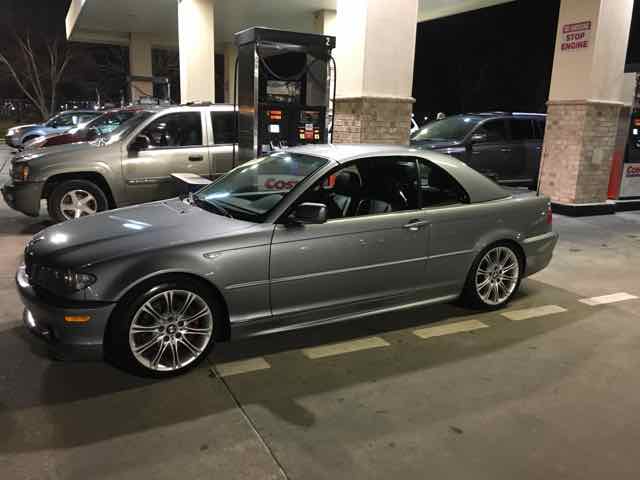

Took the removable hardtop to an auto upholstery shop and had the headliner replaced. Instead of using the black-gray color fabric of the original, we opted for a black headliner fabric with full insulation installed between the underside metal surface and the new headliner material. There was virtually no insulating material present in the original arrangement and this explains why the car was actually quieter on the trip home with the convertible top back up in place than when I was driving over to the upholstery shop with the hardtop in place.
Attachment 29372
