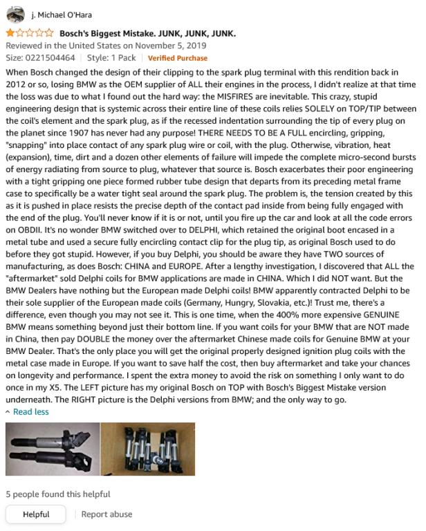

I have a misfire on Cylinder 2, suspecting the coil because none of them have ever been replaced. Should I get the Bosch or Delphi ones from FCP? Quick googling suggests both are horrible...
Apparently the problem aren't the original Boschs, but rather the new updated design that causes problems:
Attachment 38398
I've found similar comments to this, though I'm not sure how much weight I should put on them.
It's very rare that I buy used parts for my car but maybe you could buy a used OE coil as well if you can find a guy selling them cheap enough. Mine were only $10 CAD a pop, can't really go wrong for that price even if it happens to conk out a couple years down the line
Might be the best bet, gotta verify first though if that's the problem. Luckily there's a ZHP owner nearby who said I could borrow his coil to test if that is actually the problem. I might still go with new Delphi ones and just invoke that FCP warranty whenever necessary.
Lol I just ordered the Bosch one from FCP and they immediately sent me this:
https://s3.amazonaws.com/fcp-pdf-fil...0221504470.pdf
Bro cancel that order Bosch is hot garbage
You can test yourself by moving the coil to a different cylinder and seeing if the misfire follows it

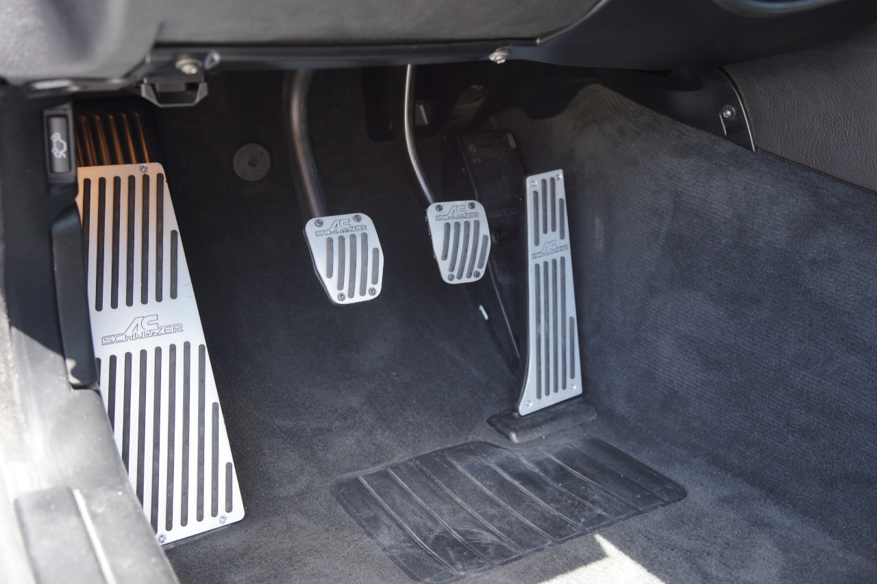

I'm running some ACS reps and love the look.
Attachment 38401
