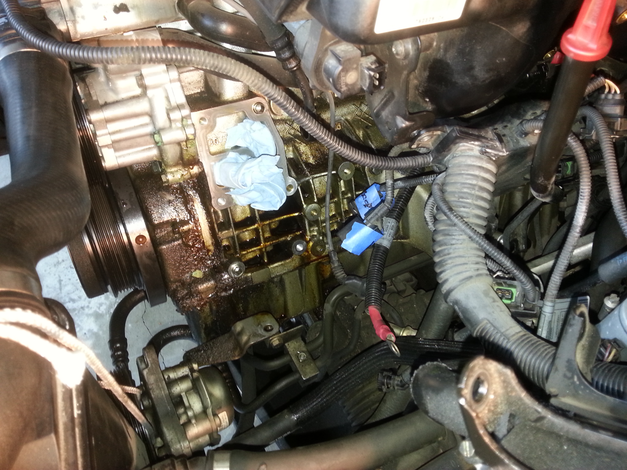

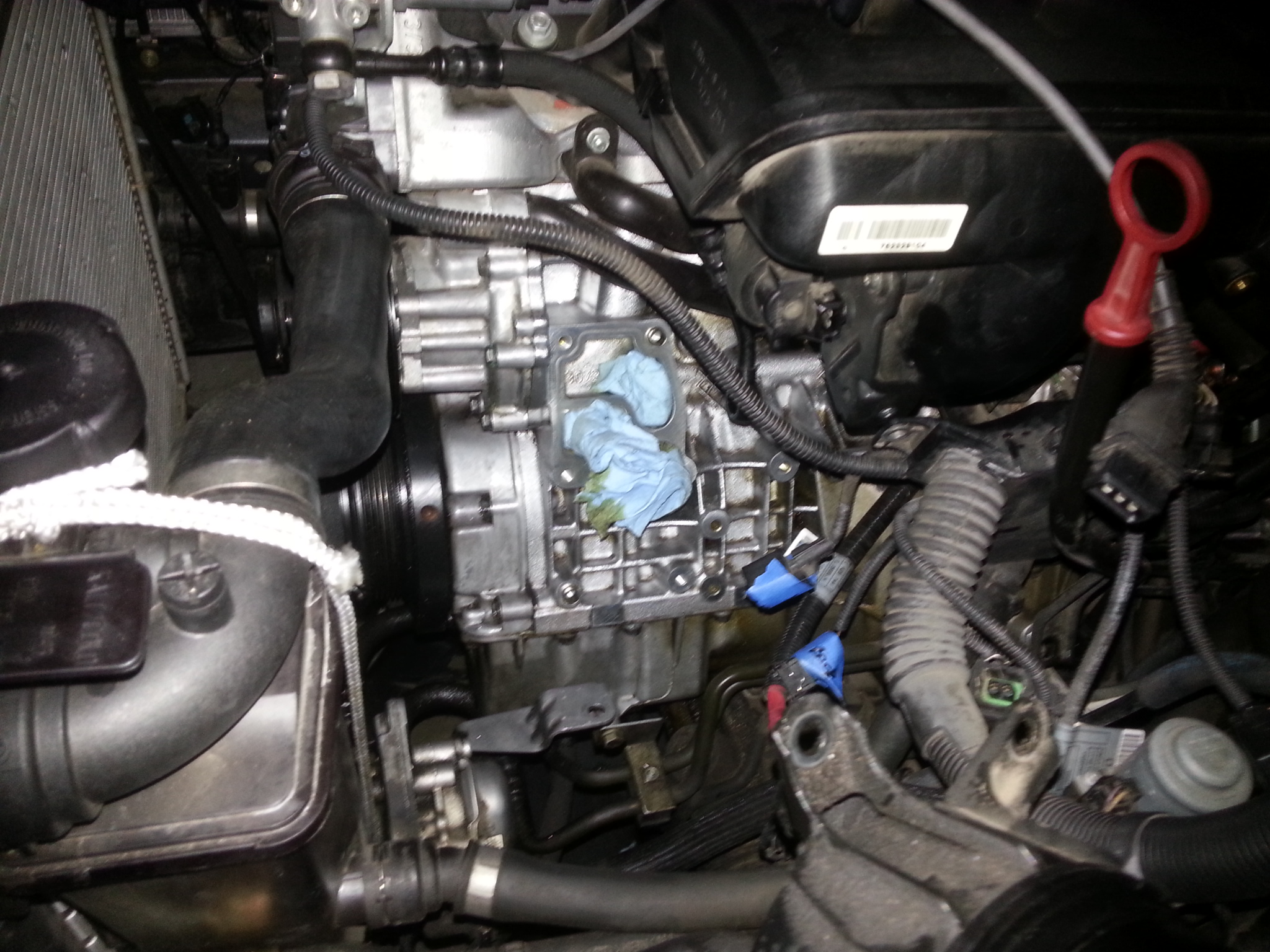

Finally got done with the pressing things. The oil separator valve was really bothering me. I did a few tests and saw that the thing wasn't working right. Sudden oil consumption, noises and such. The thing basically failed, as they do at around this mileage. While I was at it, I followed Gary's (WOFN8R) and Derek's (Derbo) advise to replace the oil filter housing gasket. Initially, I was a bit iffy about doubling my workload since I'm very limited on time these days. But I knew that it doing both would make it easier because all of the extra room you get. Needless to say, best advise I've had in a while. You really don't want to be going there more than once in a very long time. When I popped the oil filter housing off, I was shocked to see how badly the gasket had failed. See the pic below for yourself. Cleaning it all took forever. Other than that, I took my time putting it all back together--cleaning everything including throttle body and idle control valve. Also replaced the idle control valve rubber grommet, oil dipstick o-ring seal, and both intake boots. Everything came back together nicely and I didn't end up with any extra parts. The car started right away and didn't appear to show signs of trouble. I say that deserves a beer! :cheers

Nice work Giya! I told you it was a good idea to get that OFHG while you were in there! Don't want to waste all that cleaning to see that stupid gasket mess it all up again.
Thanks Derek. Honestly, I don't even know how I would do the CCV valve without all the extra room. So glad it's over :)
