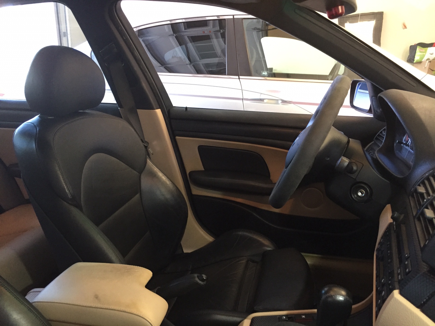

Brother got his new drivers side window in from Gerber collisions, $125, not Plinkton but not bad at all https://uploads.tapatalk-cdn.com/201...088ef61fe3.jpg
Glad he got it fixed. He should consider a $5 rattle can to refresh that lower grille.
I used Rust-Oleum Stops Rust Semi-Gloss Protective Enamel spray paint for mine and it's held up pretty darn well over the last 22 months.
