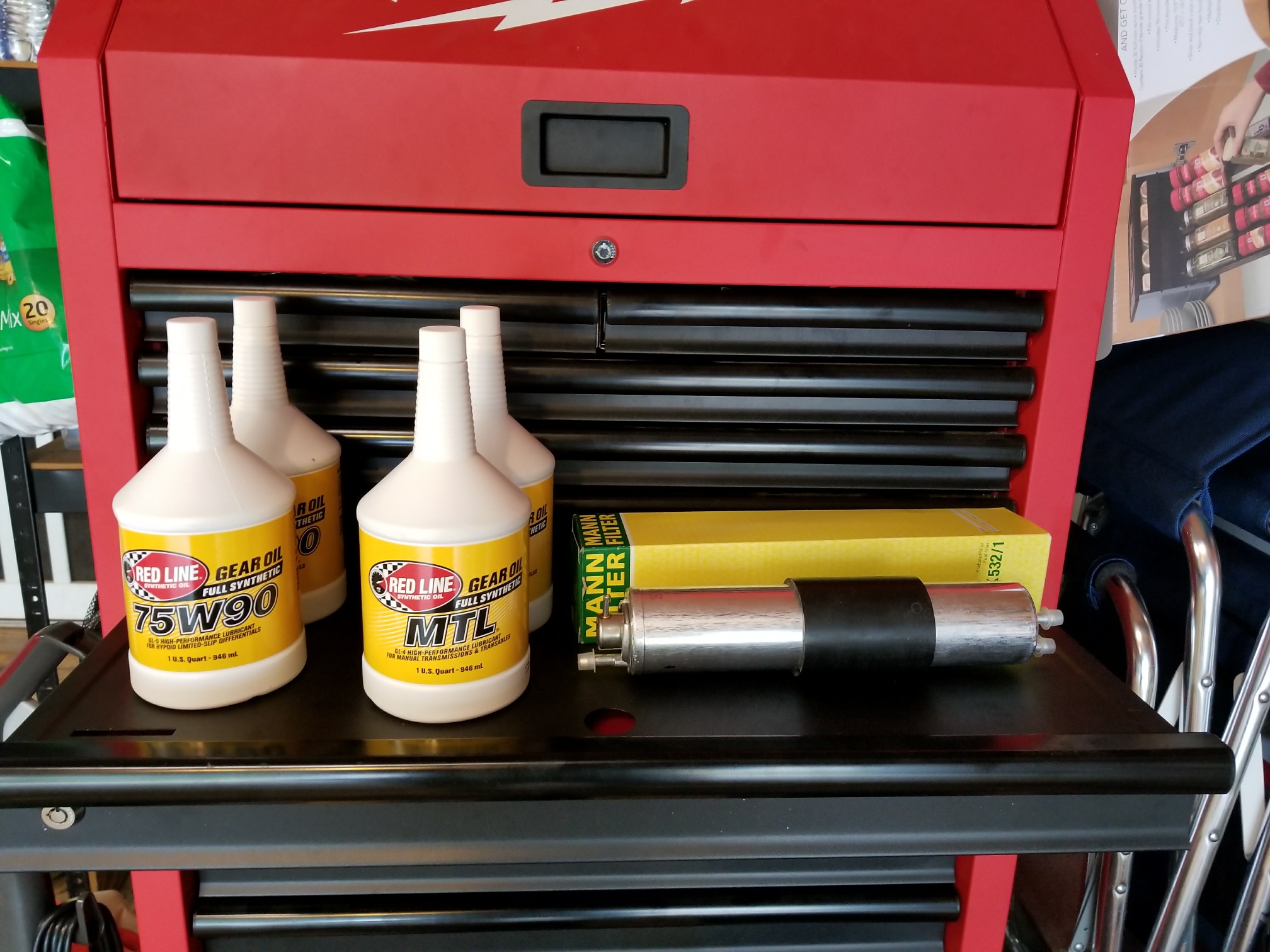

MT and Diff Fluid change, fuel filter, replaced missing lower fender liner. last weekend changed the engine oil and filter as well as flushed power steering.

If your shifting ever starts to feel weird and notchy or just plain garbage, change your transmission fluid to ATF as BMW says but if it’s perfect then keep on motoring. I had a combo of ATF/MTL in my 6MT with more bias to ATF which was perfectly fine.
