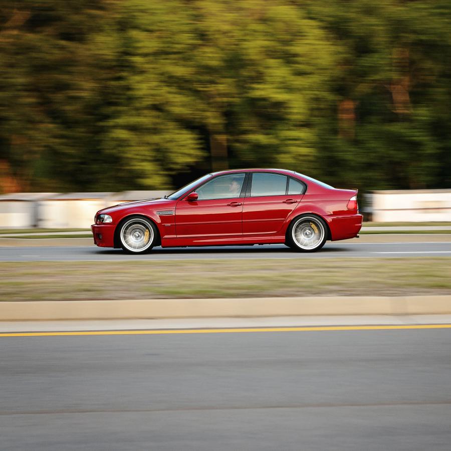

What all is needed to swap an S54 into our cars the best way possible? front to rear bumper, whats the best way to make that swap work.
I'm not sure, but user "nextelbuddy" on nam3forum.com has a great example of what you're talking about. Maybe he has a build page in his post history (link).
https://nam3forum.com/forums/filedat...6&d=1687239707

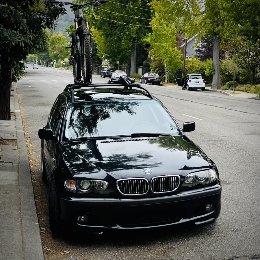

User Bry5on has a great example. Wagon, too!
(link to build page)
https://nam3forum.com/forums/filedat...0&d=1670813853
