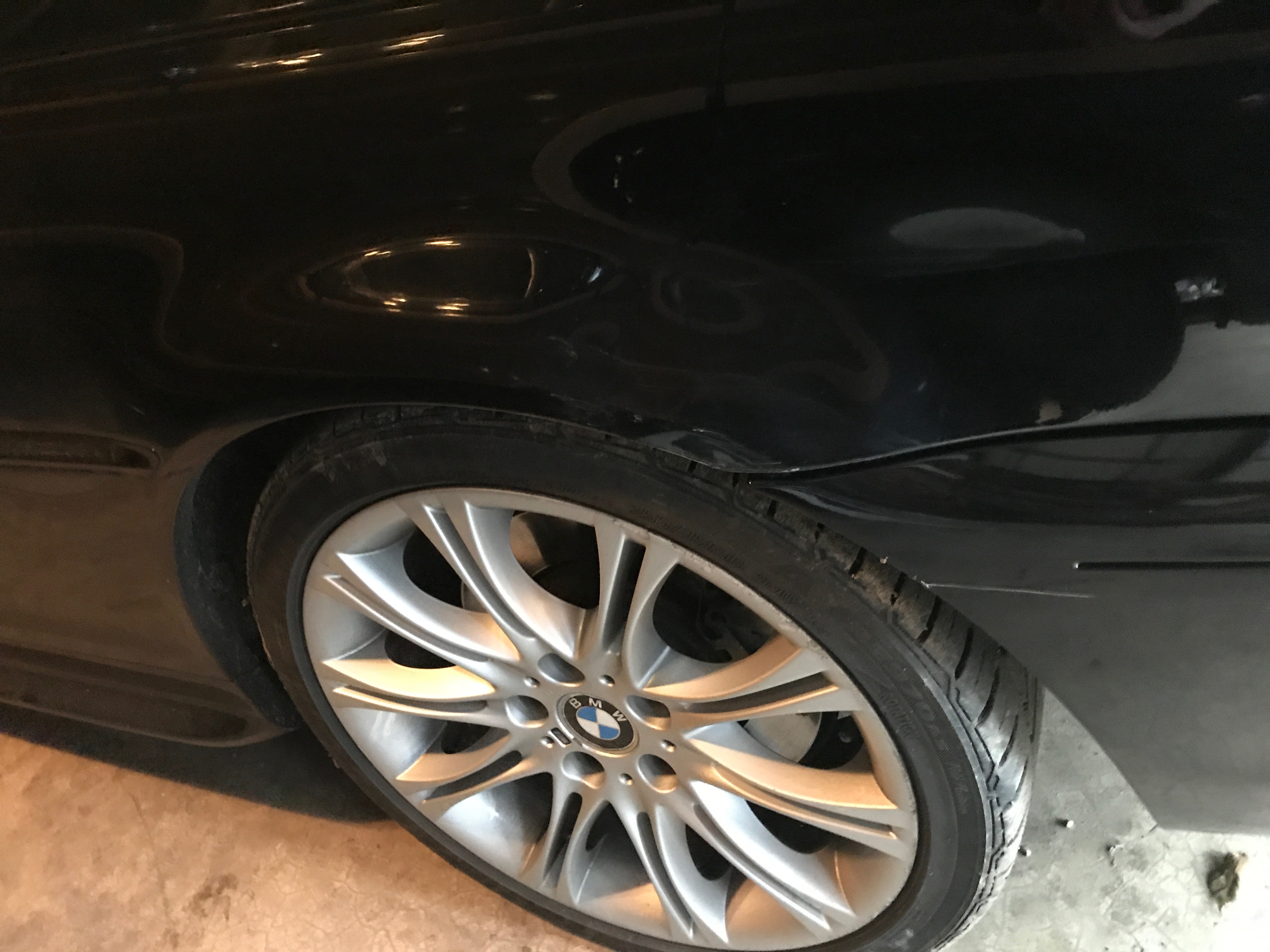

Forgot to post pictures of the damage to my brother's car from having it roll back into the side of the house:
Attachment 31446
