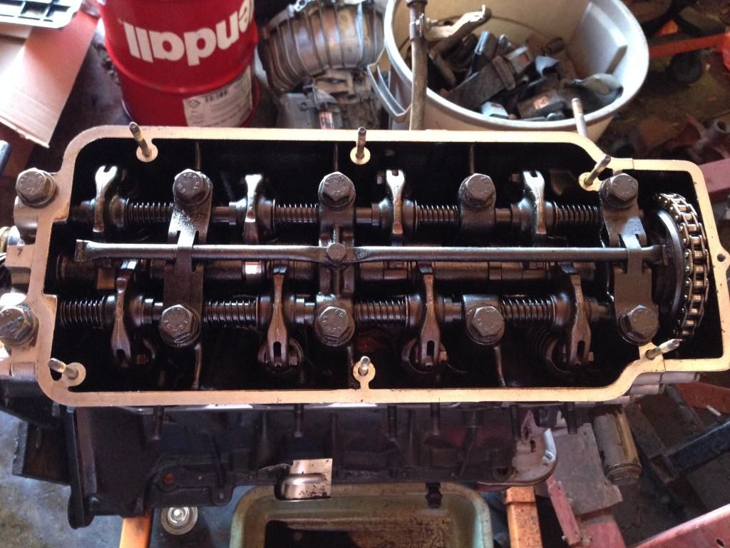

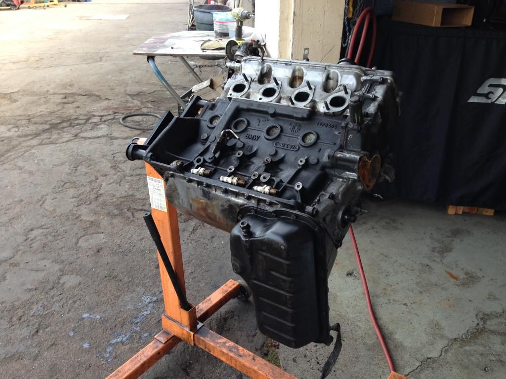

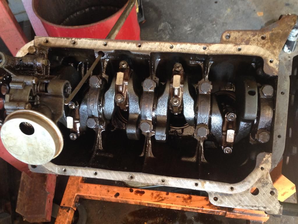

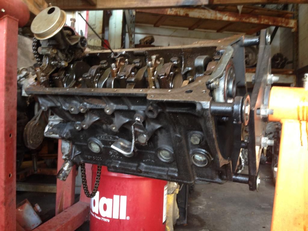

I am also going to modify the engine before I install: 2012cc, 284 Schrick, 9.5:1, Volvo MAF and ECU, M50 injectors

It's not pretty, but I've seen worse
I love how all of these parts from different manufacturers work together.

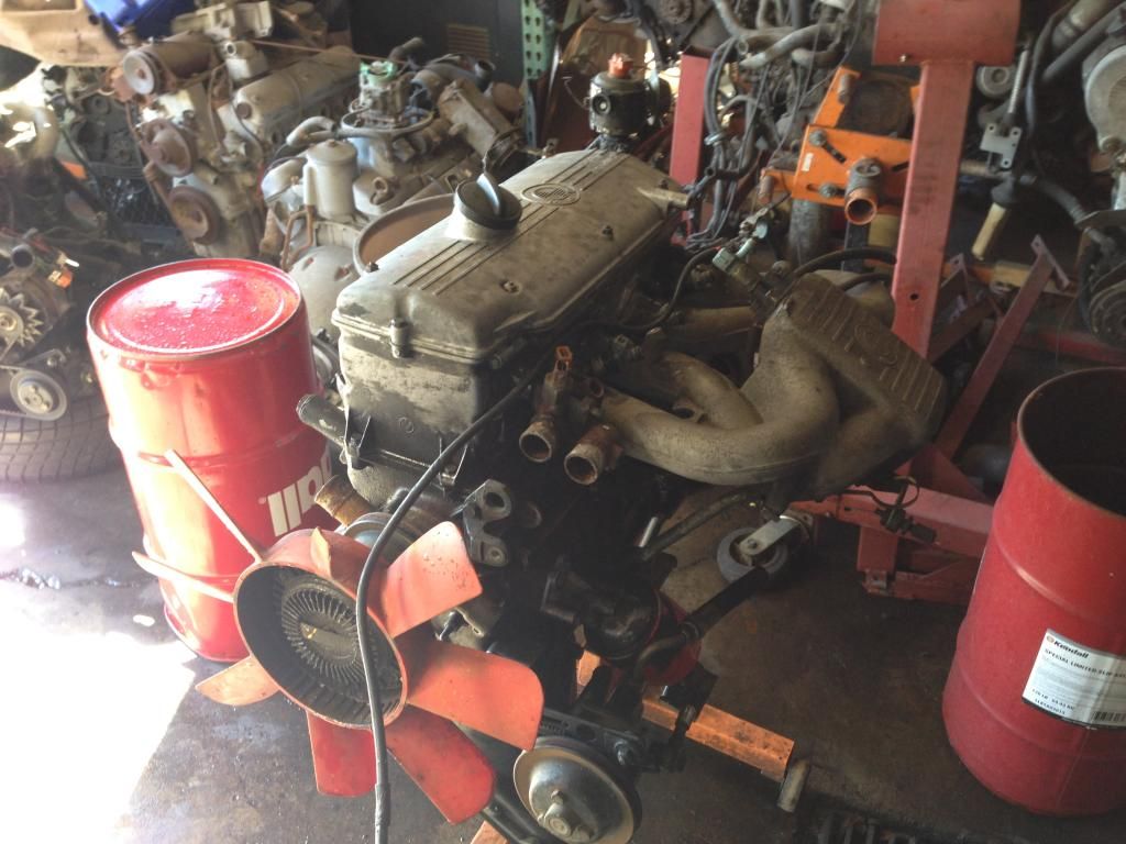

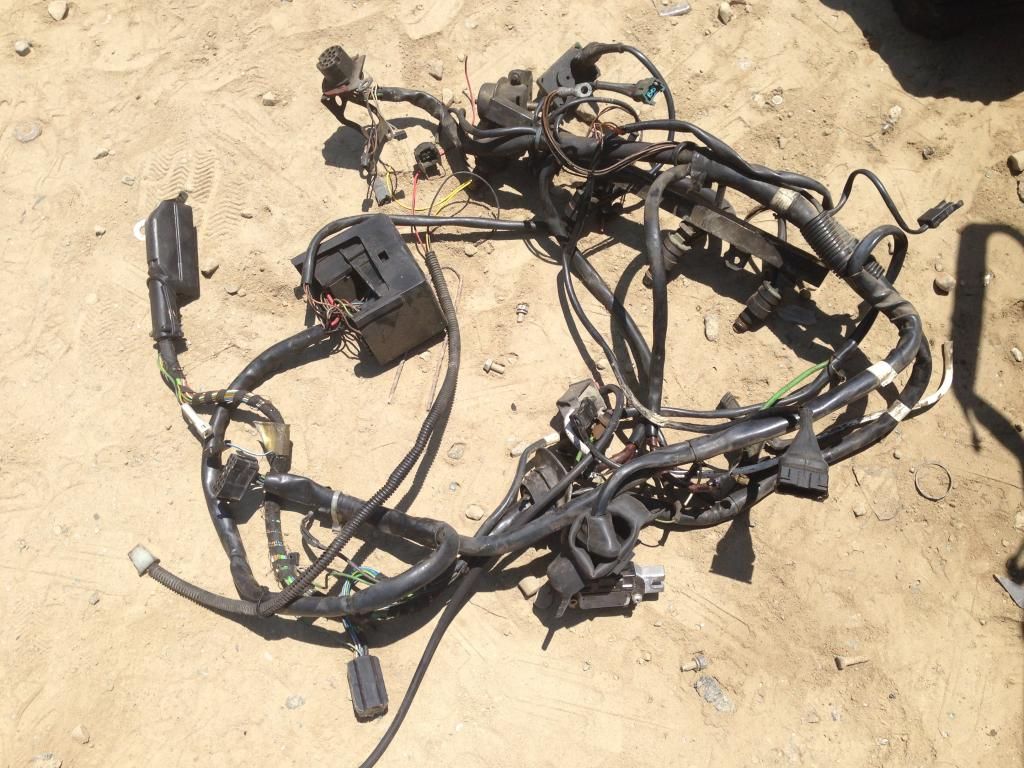

Found a 318 at the junkyard... engine harness, fuel rail, and some assorted crap (not pictured) = $20
http://i29.photobucket.com/albums/c2...EE00463F66.jpg
Nice haul!!
