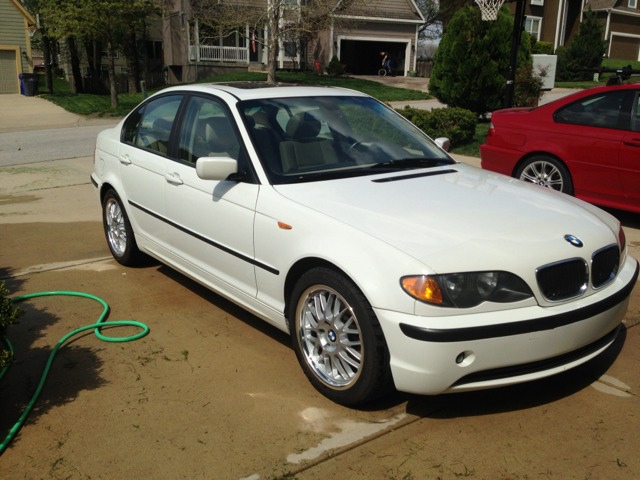

Cleaned up my other E46 today.
It may be even less special than our "not special" ZHPs, but it still shines up pretty good. I was working on the engine compartment Scrubbing Bubbles DIY, and the guy across the street came over and asked if I wanted to sell it.
I don't think I do.
