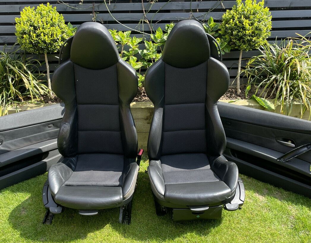

I did it today - bought some new seats for the ZHP to try out - BMW e85 M sport seats in fabric/leather layout. Heated, Manual adjust seats. I saw them on auction a few days ago and started feverishly doing research into them since I knew these are directly swappable into our cars (sedan/coupe anyways, I think convertible might need adjustments). The manuals are half the weight of powered and I rarely adjust my seats anyways. I've also been chatting with someone who's completed this mod to their ZHP to understand what it's like living with these seats. Excited to mod the car and try them out soon.

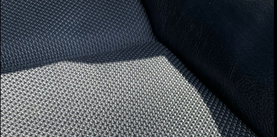

I have an alcantara interior that's in very good shape and in no need of replacement, so I felt this config would be the best one to fit right in with the current interior, plus I prefer fabric (no sliding around). I'm pretty sure the pattern won't match the ZHP/alcantara fabric pattern, but I think it will at least color match.

Attachment 39046
Attachment 39047
