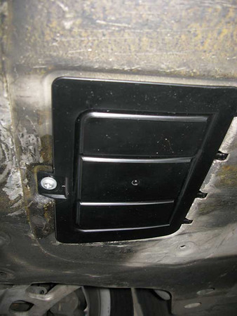

Cleaned the under-side of the car. It was pretty filthy from the OFHG leak and installed the little door that covers the oil drain bolt area. Finally get to drive it tomorrow! :roundel
Borrowed this pic from another member but this is exactly what it looks like installed.
Attachment 11202
Nice! :chuck
