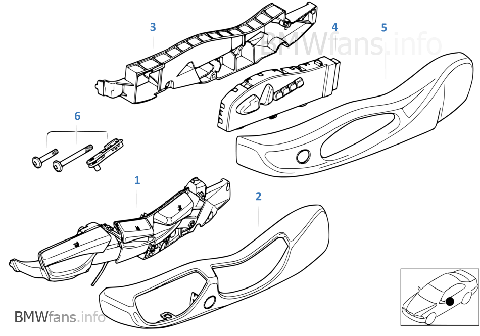

Found out where my voltage issues were coming from. The driver side memory seat module is failing (#4). Will need to order a new one. Thankfully it is not *too* expensive.
Attachment 19916
http://bmwfans.info/parts-catalog/E4...?s=61307036125
How did you figure that out?
Deduction Dr. Watson.
For a while now my passenger side mirror would always adjust to a different position when I would unlock and sometimes lock the bar. A bit frustrating to be quite honest. In fall, my angel eyes starting flickering badly. After replaing the alternator in fall and having a fairly new battery I decided not to deal with it until spring. With spring here, I used torque to see the voltage swings.
I ran out ideas to see what it could be. So I unplugged the driver seat. Problem found. The bad news when doing this my airbag light is now always on and torque won't reset it
